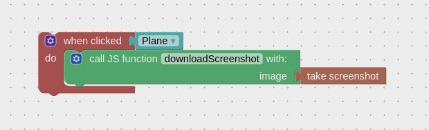

    I want to add a button to save the current view of a object to a jpg file
    Is it possible?
    Thanks
    #18604
    You can use the take screenshot puzzle for that (also need to enable screenshots with configure app puzzle). It only generates the image though. To be able to download it, you can use the following JavaScript snippet
        app.ExternalInterface.downloadScreenshot = function(image) {
            var link = document.createElement('a');
            link.setAttribute('download', 'myImage.png');
            link.setAttribute('href', image);
            link.click();
    and call it from Puzzles as described here.
    Attached an example project.
    #18609
    Update:
    make it
            document.body.appendChild(link);
            link.click();
    to work on Firefox.
