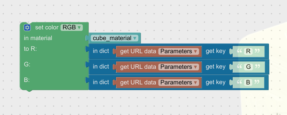

Alexander KovelenovStaffHi,
you probably need to do something simple like:
http://brudastan.de/wp-content/uploads/verge3d/2507/Brudi.html?R=0&G=0.5&B=0.5
P.S: You might also need to reduce the size of the default normal map and disable SSAO (it works really slow on thye low-end and middle-end hardware).
