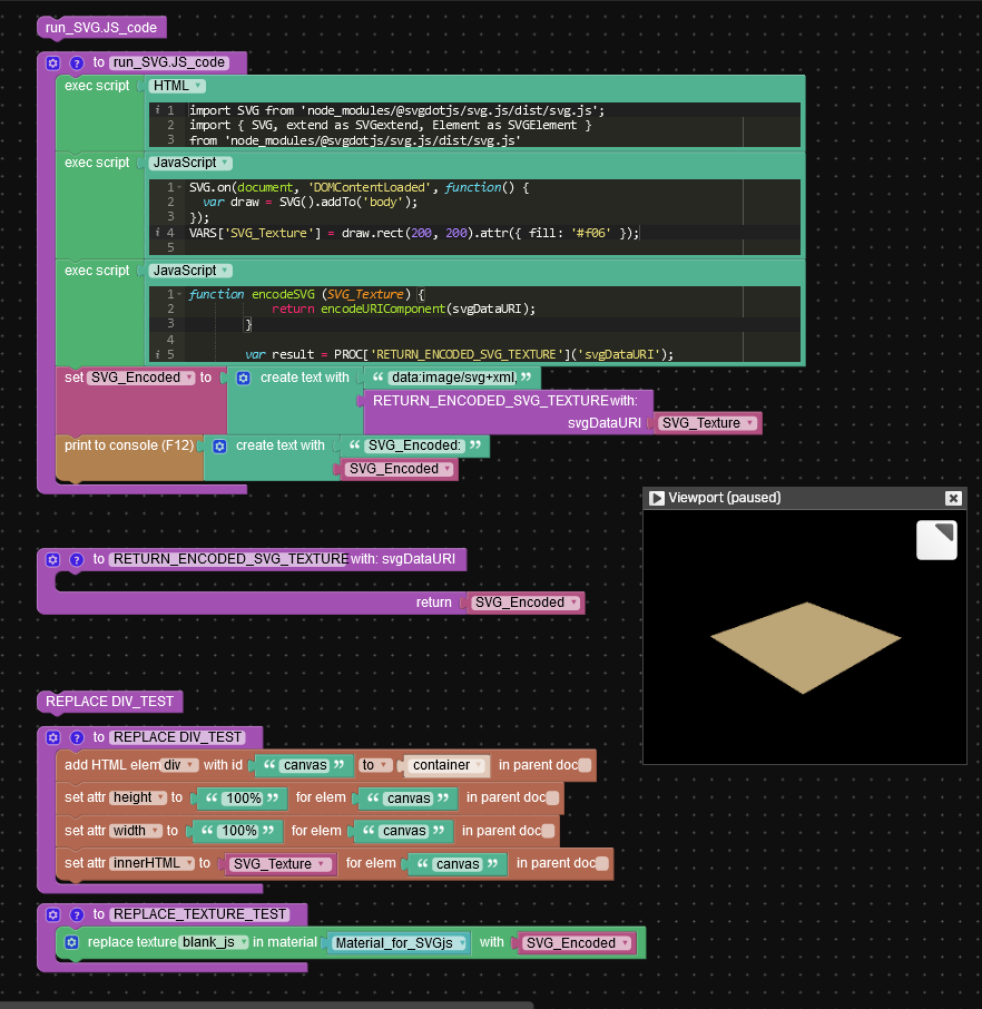

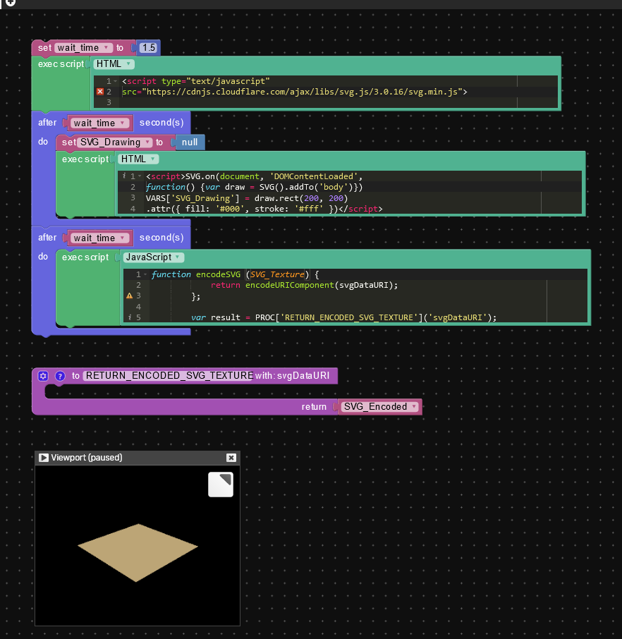

GLiFTeKCustomeryea sure here you go…
the second doesn’t have the drawing var going into the procedure yet.
how are the naming and config on the first doing? the svgDataURI going from the test to the input in the procedure should work?”

GLiFTeKCustomerhmmm..
I can’t use the HTML text puzzle.
I get this Console Error message every time….” Uncaught SyntaxError: expected expression, got ‘<‘ ”
it’s referring to the “<” at the beginning of the first character in the code, which it’s tips demand..
“<!DOCTYPE html>”
(same happens with any HTML tag pointed braces.)Visit the GLIFTEK Verge3D Plugins Store!

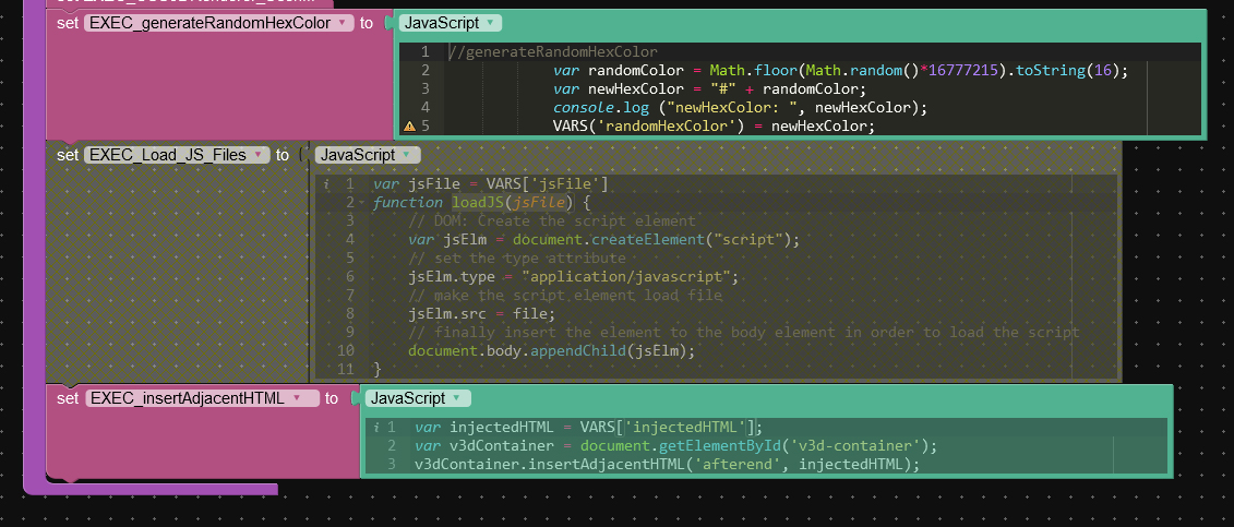

What does the green overlay coloring that goes over the text when you use it in an exec puzzle mean?
By the way this exec/multi line text puzzle is awesome!
can you post a screenshot?
2020-09-14 at 2:46 pm #32857
GLiFTeKCustomerit happens to text puzzles that are UNDER a disabled variable that holds a text puzzle.
plz share Discord link & on your signature!2020-09-15 at 7:52 am #32880
Ivan LyubovnikovStaffThanks GlifTek, we’ll fix that in the next update!
