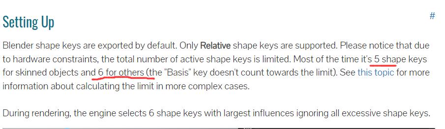

    In this threejs case, more than 50 deformation targets can be used. Why is verge3d limited to 6 target deformations at most? This will make it impossible to use verge3d to display the character’s expression. Will this restriction be opened in subsequent versions?

    What version of Verge3D are you using?
    If you’re using Verge3D 4.0 pre1 build or newer, you can use unlimited morph targets.
    Read this update to see where it mentions that:
    Verge3D 4.0 pre1 available!
