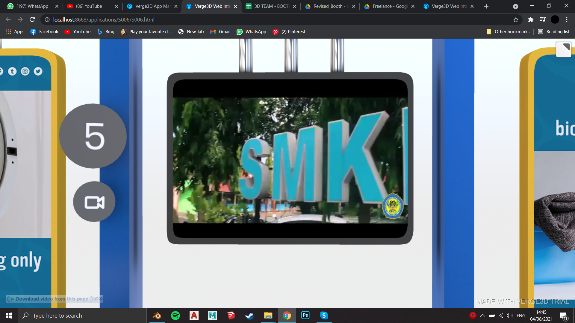

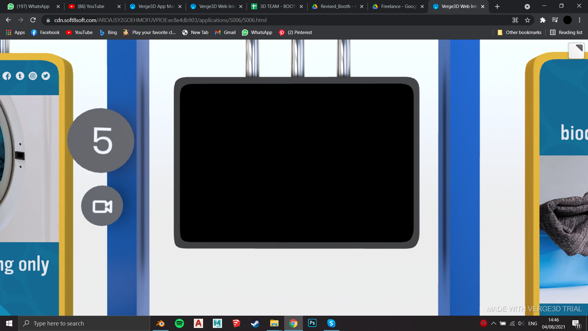

    Hello
    So i use verge 3D to make a Booth exhibition, in that model i put some video using texture with Mp4 format
    In the first picture :
    When i click the normal verge which is (Localhost) link, it normal and i can play the video actually
    In the second picture :
    But after i publish the model, and klik cdn.soft8soft link, the video turn to black and i can’t play anything

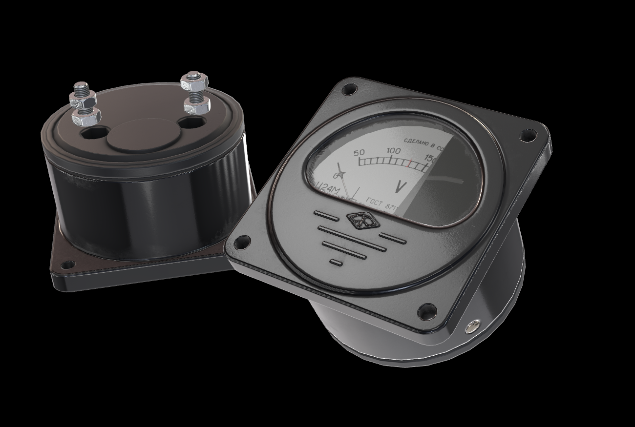

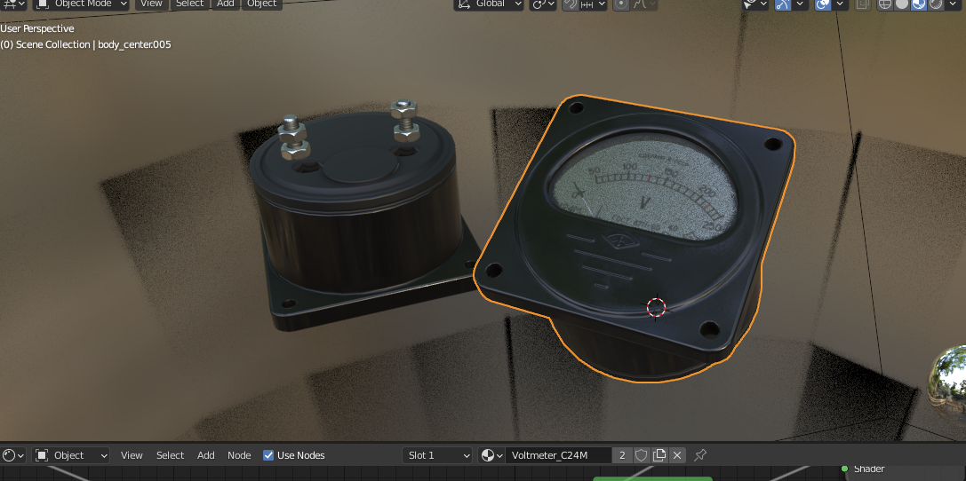

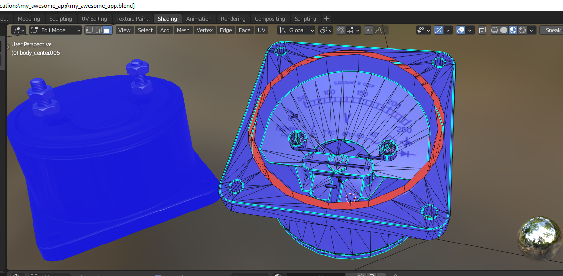

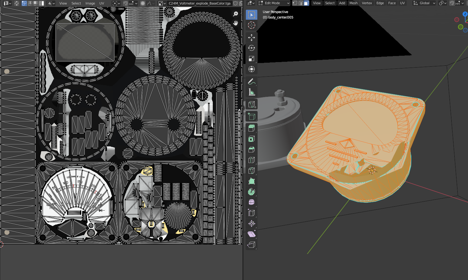

    I got an issue. Exploding model to parts and making render order fixes it

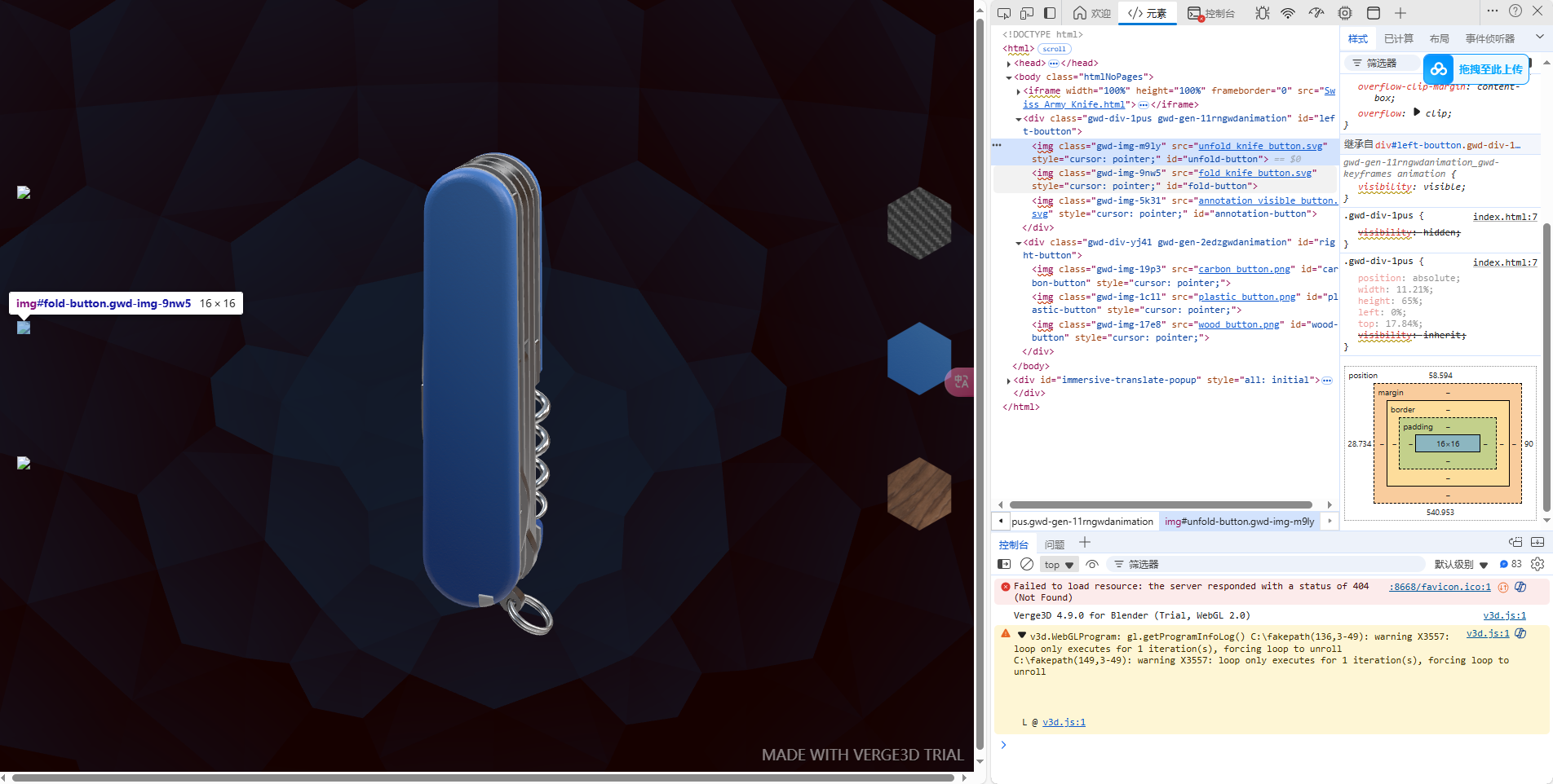

    #80844
    wangrui

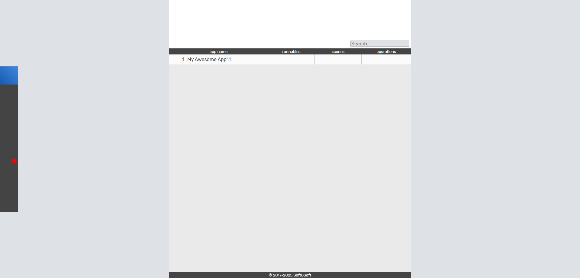

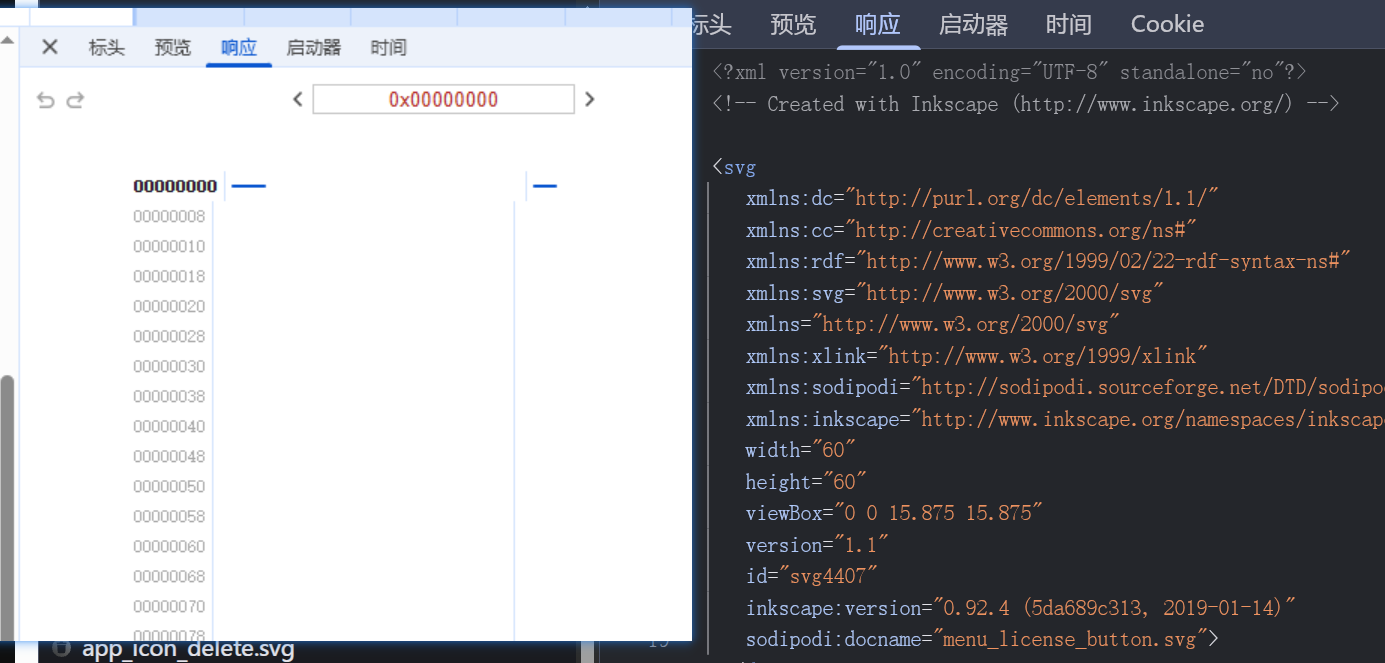

    After updating version 4.9, the icon can’t be loaded, but the function can be used. When you enter the web development mode, you find that the svg file response is 00000000.
    #80848
    What OS version you use? Have you upgraded from another version? If so you might cleanup the old version entirely and install 4.9 from scratch.
    Also, please copy-past the content of the app manager log: http://localhost:8668/log
    #80850
    wangrui
    V3D-AM-INFO: Starting App Manager server (Verge3D for Blender)
    V3D-AM-INFO: Serving network port: 8668
    V3D-AM-INFO: System: Windows-10-10.0.19045-SP0
    V3D-AM-INFO: Python: 3.12.1 (tags/v3.12.1:2305ca5, Dec 7 2023, 22:03:25) [MSC v.1937 64 bit (AMD64)]
    V3D-AM-INFO: Executable: D:\Verge3D_for_Blender\python\windows\python.exe
    V3D-AM-INFO: Filesystem encoding: utf-8
    V3D-AM-INFO: Version: 4.9.0 (RELEASE)
    V3D-AM-INFO: License: Trial (expires 22.04.2025)
    V3D-AM-INFO: Root folder: D:\Verge3D_for_Blender
    V3D-AM-INFO: Applications folder: D:\桌面\桌面\verge 3D
    V3D-AM-INFO: Network cache age: 15 minutes
    V3D-AM-INFO: Temporary folder: C:\Users\Administrator\AppData\Local\Temp\verge3d_tmp_lkzbcxg3
    I have cleaned up the old version, downloaded the new version 4.9 again, and tried to restore the old version to no avail.
    #80851
    I see, if you install it on disk C: in the default installation folder (C:\Program Files\Verge3D_for_Blender) will it work?
    #80853
    wangrui
    It won’t.I understand that there is another community group in China that is in the same situation as me, which may be a problem that needs attention.
    #80855
    Try one of these steps:
    1) Check if some other browser works (e.g. Firefox)
    2) Reset App manager settings with http://localhost:8668/reset
    3) Restart your PC then install Verge3D into some other folder
    4) Check Blender addon settings, maybe Verge3D addon is loaded twice or have different version
    Also please provide the contents of Blender console (Window ‣ Toggle System Console menu).
    BTW what Blender version you use?
    #80868
    dx556po
    I also have the same problem, not just http://localhost:8668/ The icon is missing, just like the SVG file provided in the case. It was missing when I turned on my computer today. Is this because I used Google Web Designer?
