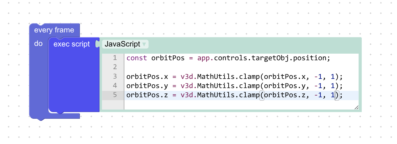

    You might try out the following snippet. It works, but not quite seamless:
    limit camera pan puzzle
    const orbitPos = app.controls.targetObj.position;
    orbitPos.x = v3d.MathUtils.clamp(orbitPos.x, -1, 1);
    orbitPos.y = v3d.MathUtils.clamp(orbitPos.y, -1, 1);
    orbitPos.z = v3d.MathUtils.clamp(orbitPos.z, -1, 1);
    Replace -1 and 1 with actual panning limits.

    Wonderfull ! it works !
    Just if someone else want to use it from 3dsmax : it is Y-up (the up is Y, not Z)
