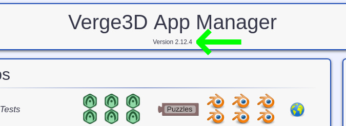

    Please find below some advice that may help us resolve your issue faster.
    First of all, make sure that you are using the latest Verge3D version available for download. You can check your current version in the App Manager.
    how to obtain version of Verge3D
    Update your Verge3D installation and the applications if this is not the case.

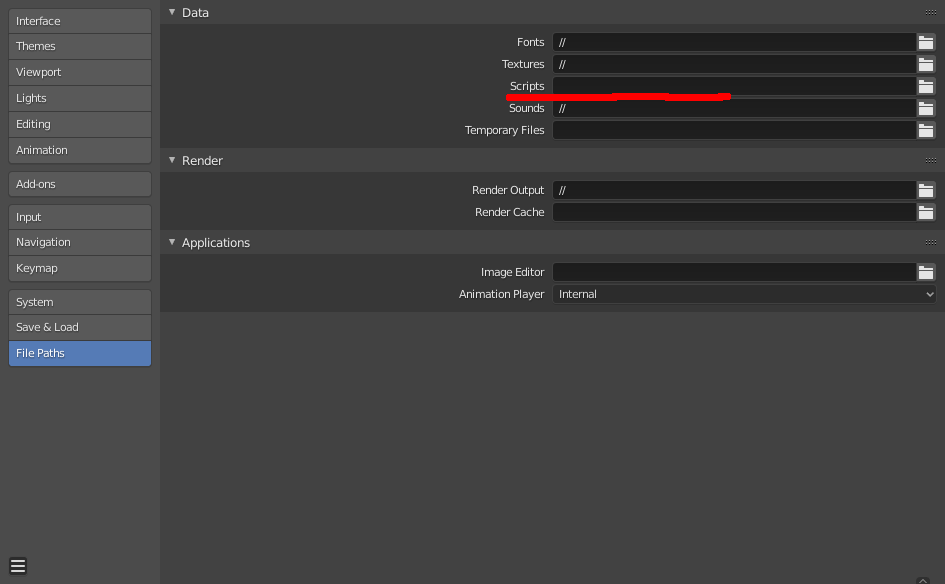

    #23033
    I can’t use verge3d 2.17.1. I don’t know whats the problem. Anybody solve my problem. I’m new to verge3D.
    From the screenshot you posted it appears that Blender still refers to the old verge3d version, because it says 2.16.1 in the addon preferences. I suppose that this is the cause of the issue.
    Can you tell us how you updated verge3d to the new version? I suggest following these tutorials to avoid installation issues: Updating for New Versions and Installation – Verge3D for Blender
    Also, it’s better to check that Blender doesn’t refer to verge3d addon in the File Paths -> Scripts option:
