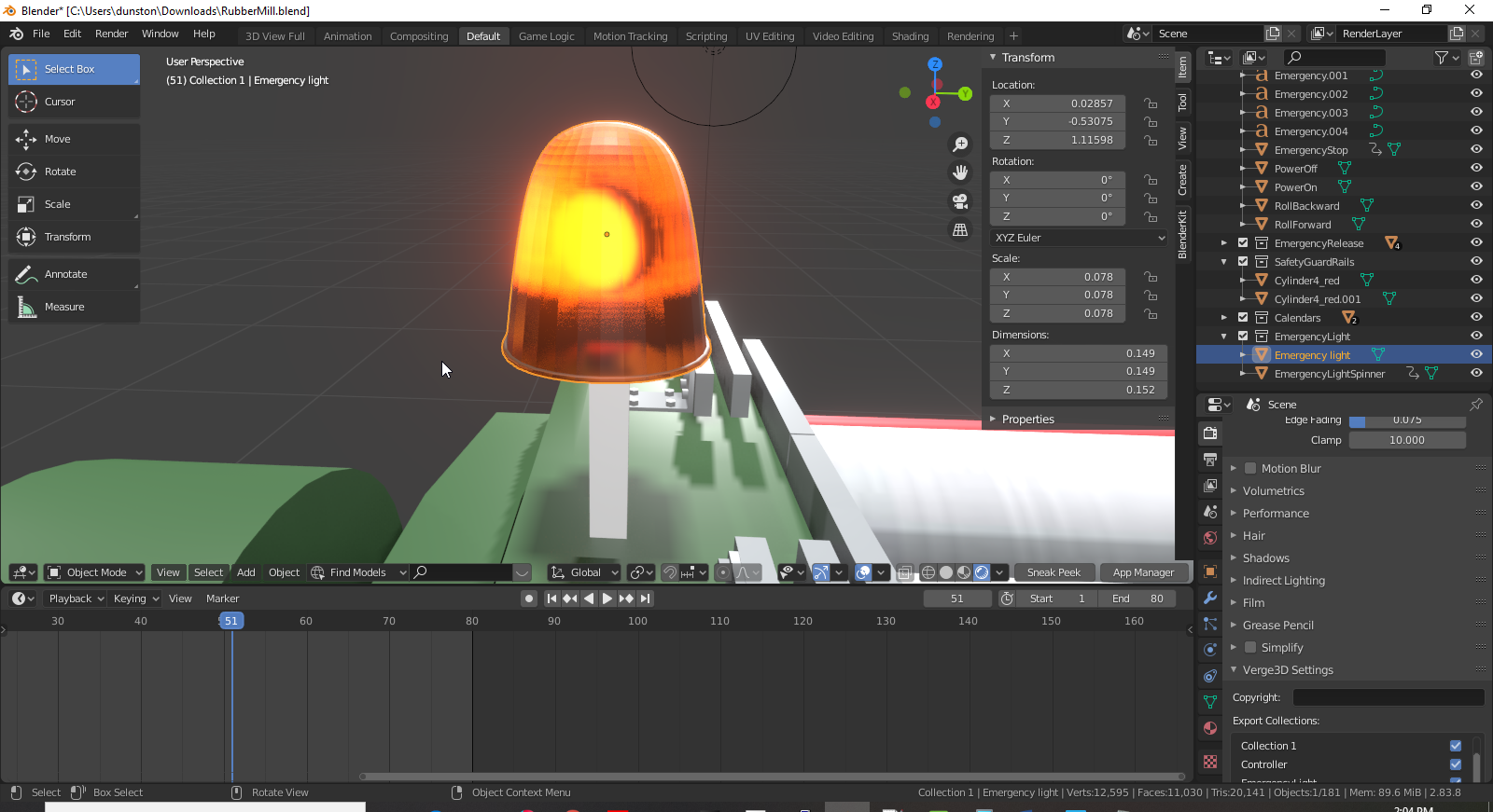

I am having trouble with the render from Blender (2.83) to Verge3D (3.50).
I am using Microsoft Edge:
Microsoft EdgeHTML 18.19041

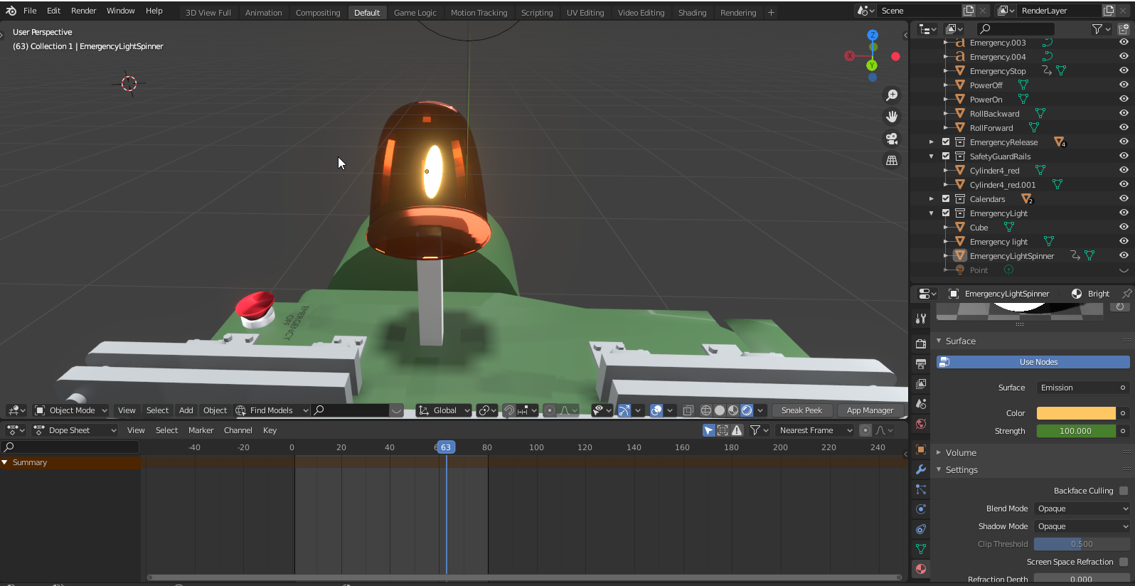

Microsoft Edge 44.19041.423.0I followed this tutorial to create an Beacon:

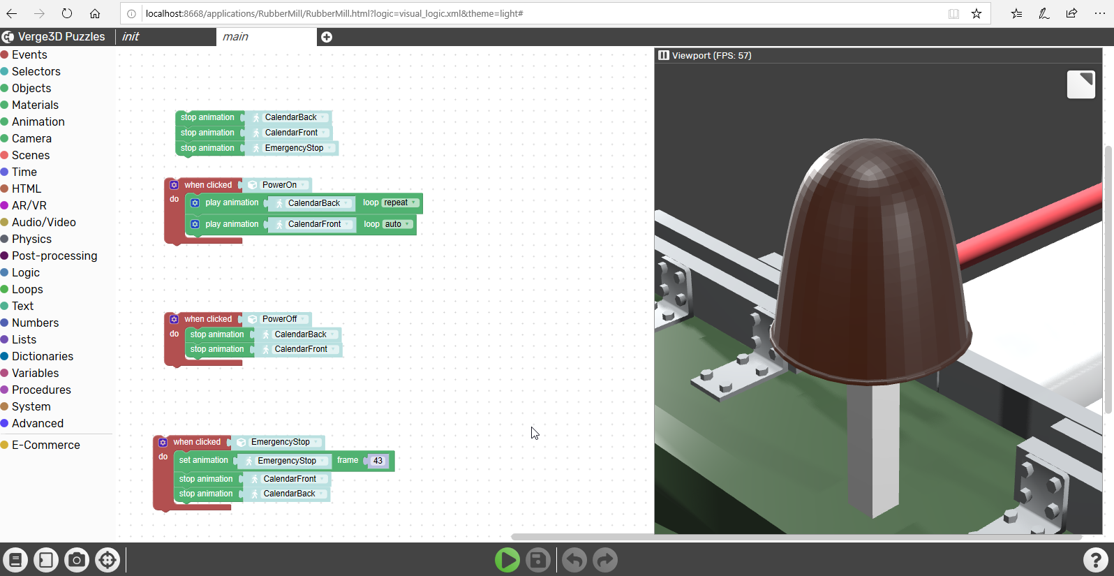

I’ve attached how the beacon looks in Blender and how it renders in Verge3D. The animation works, but not the light material and you can see the difference in how the model renders.
2020-12-30 at 6:31 pm #36974
Mikhail LuzyaninStaffYou have a sub modifier on the object, but it’s not applied automatically on export, you need to apply it manually or set Bake Modifiers in Verge3D settings of Render Settings panel.
2020-12-30 at 7:07 pm #36976ddunston
CustomerThank you! Applying the submodifier worked. I’ll make note to check that next time.
The problem I have now is that the material is not picking up the glass effect and the light doesn’t shine through.
I can’t find this setting which may resolve it “Bake Modifiers in Verge3D settings of Render Settings.”

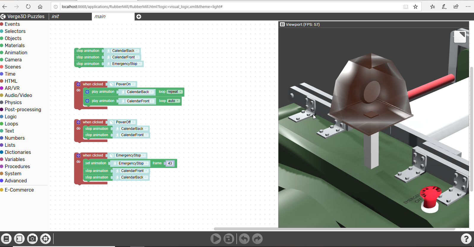

Update: 12/31/2020 I tried adding the material to the beacon shape and the material to the light spinner inside using the visual code blocks and it doesn’t work.

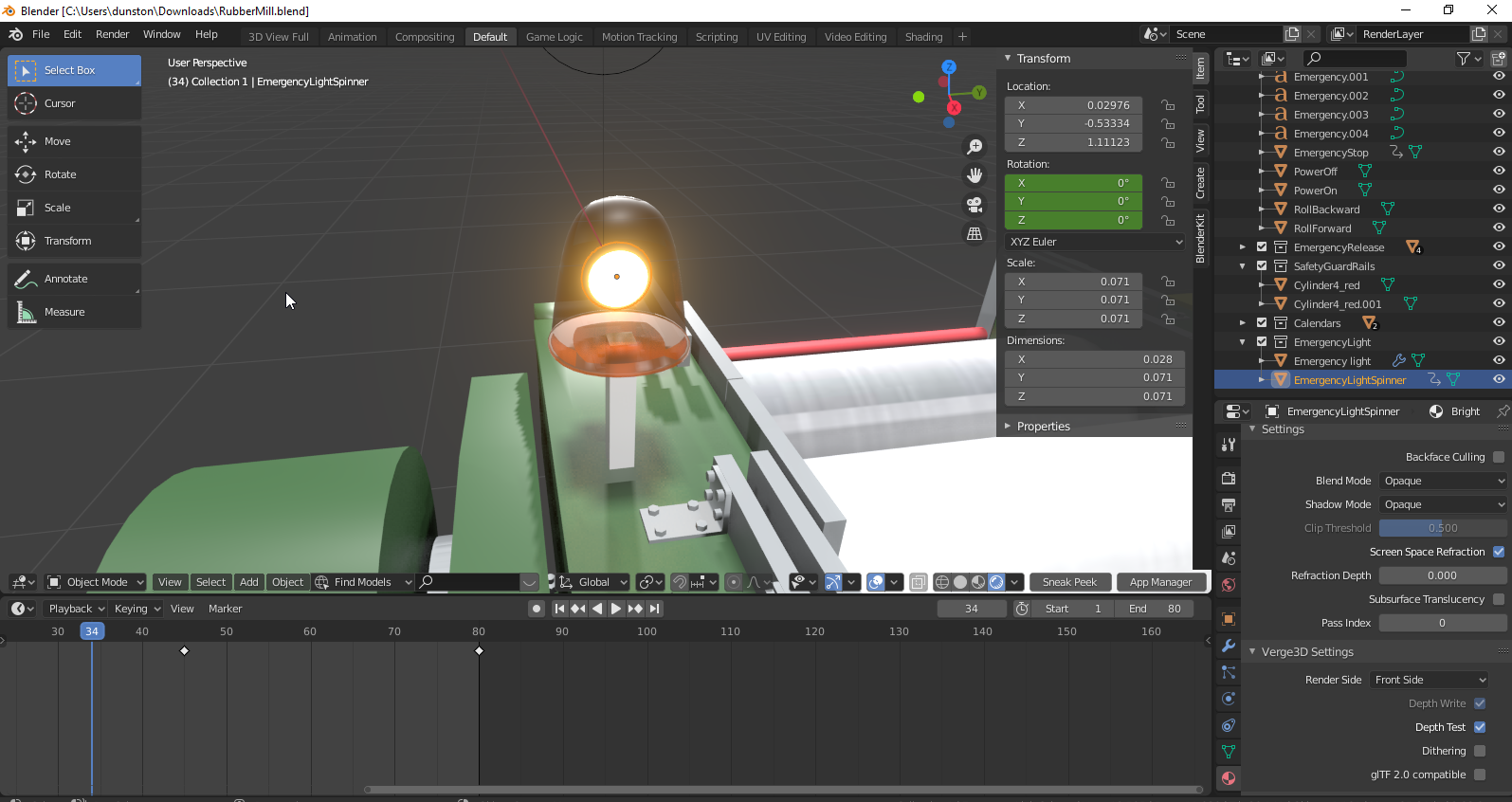

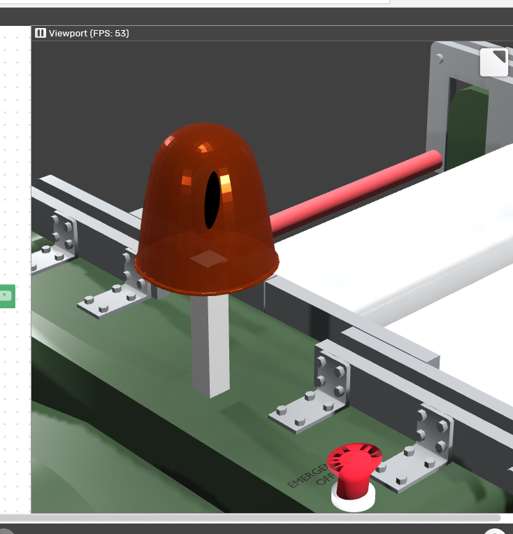

Yuri KovelenovStaff2021-01-01 at 5:09 pm #37020ddunston
CustomerHello,
I did enable transparency using Alpha Blend and changing the Alpha level. That worked and I could see the spinner inside the 3D model within Verge3D.
However, the “Emission” surface is not working on the spinner. I have the setting set to white and the strength set to 100. The spinner does not show the Emission material. It is dull.
I also tried adding in a point light and changed it red and that doesn’t display at all. I tried playing with the new light puzzle filters on the point light and nothing happens.

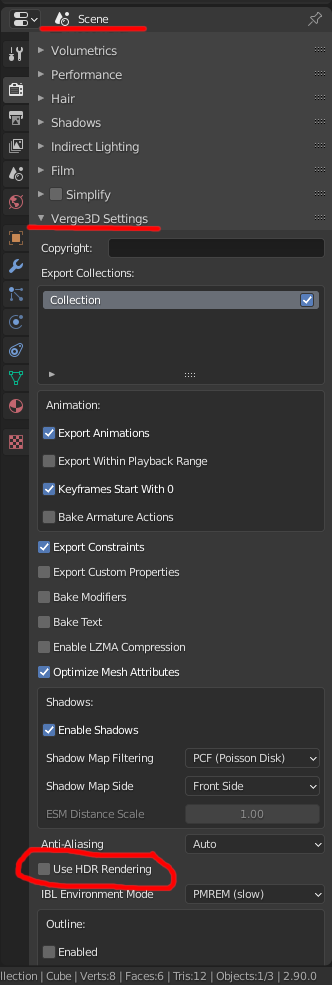

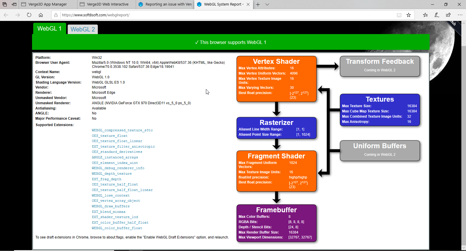

Mikhail LuzyaninStaffTry to enable HDRI rendering in Verge3D settings in Render Tab.
2021-01-14 at 1:33 am #37367ddunston
CustomerSorry for the late reply. I do not see that option and looked at the documentation and don’t see the option to enable HDRI renderings.
2021-01-14 at 7:13 am #37371
Mikhail LuzyaninStaff2021-01-14 at 3:03 pm #37392ddunston
CustomerThat didn’t work either. I’m going to work on an alternative solution. Thank you for your assistance.
2021-01-15 at 6:55 am #37397
Mikhail LuzyaninStaffHere’s an example for you with solution.

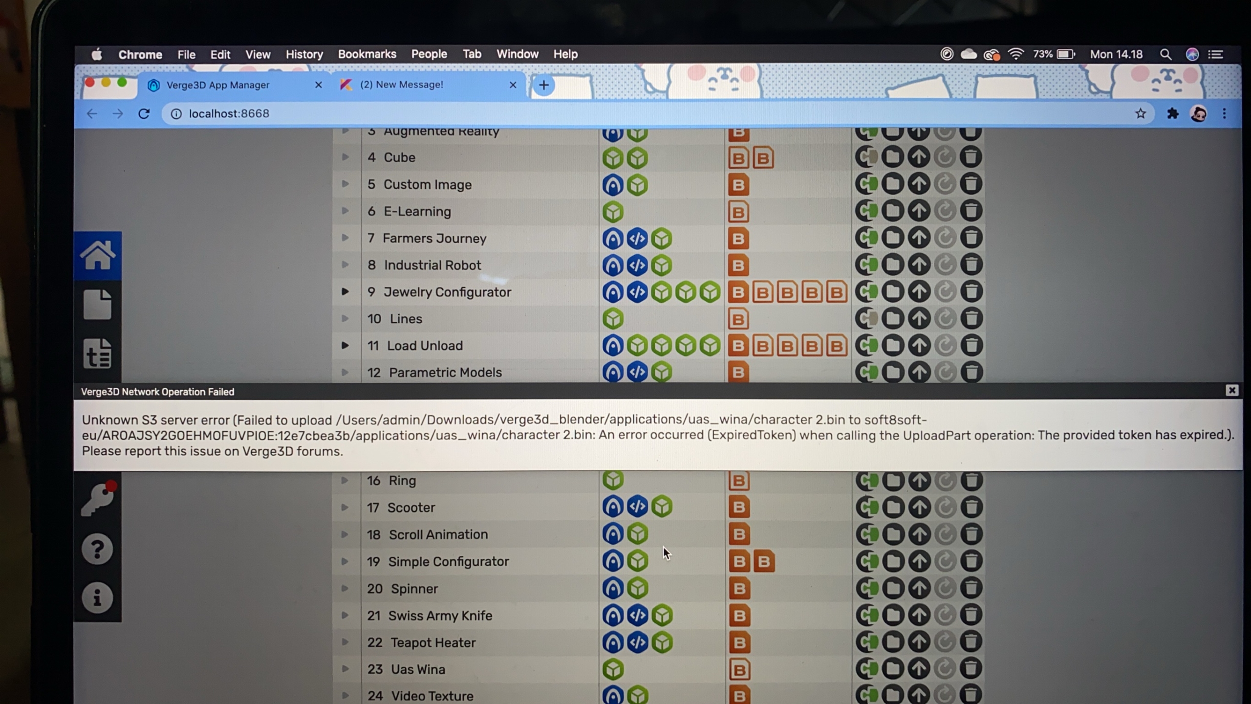

2021-02-08 at 9:59 am #38187winacecilia03
Participanti tried to uploading my file in app manager, but it always 12%. And after i waitting for about 1 hour, it error. how to fix it??
