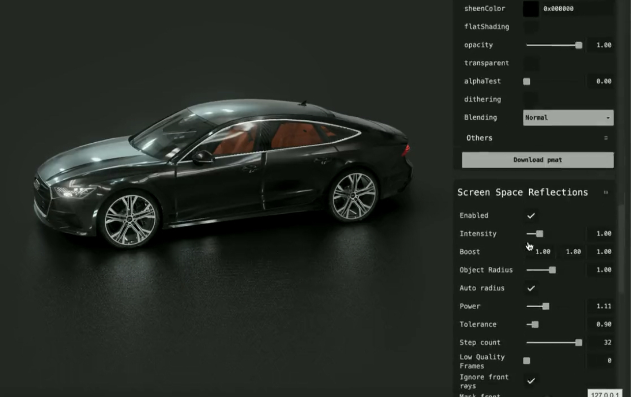

    Hi Soft8Soft!
    Came across this on the internet, from a developer that is using ray-traced SSR w/ three.js– is this something that could be possibly coming with V3D 4.0? I’m guessing this is a new development in three.js…
    Really looking forward to what’s next for Verge3D, as always!
    #49458
    This wold be very slow for most devices for now.
    #61123
    That’s not for using in dynamics. That could be a possibility to render a good-looking screenshot.
    #61147

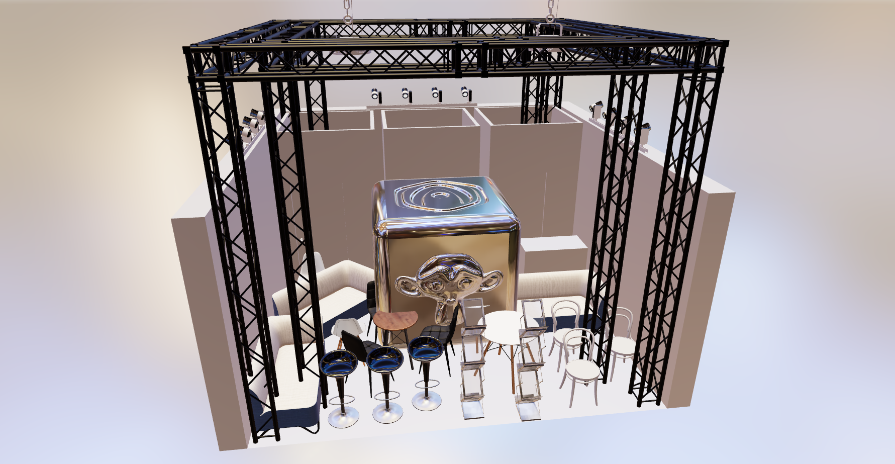

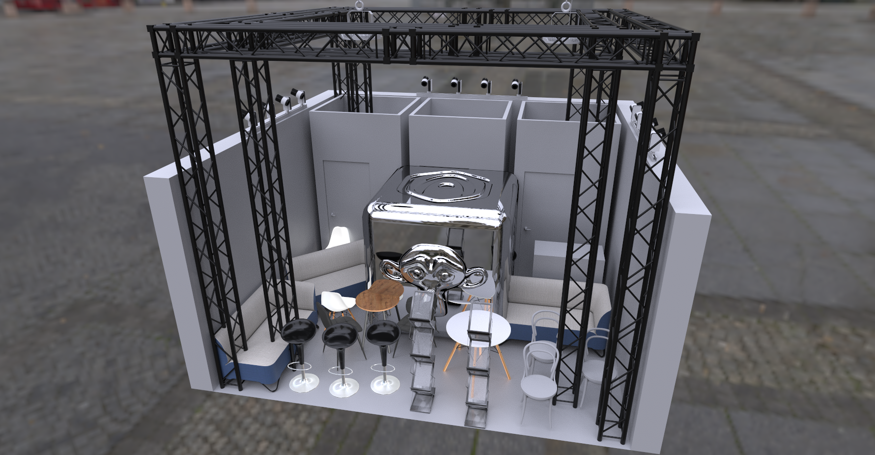

    #61156
    Or maybe I already know ))) It’s not dynamic SSR/Ray tracing, it’s just a path traced rendering.
    https://v3d.net/g8n

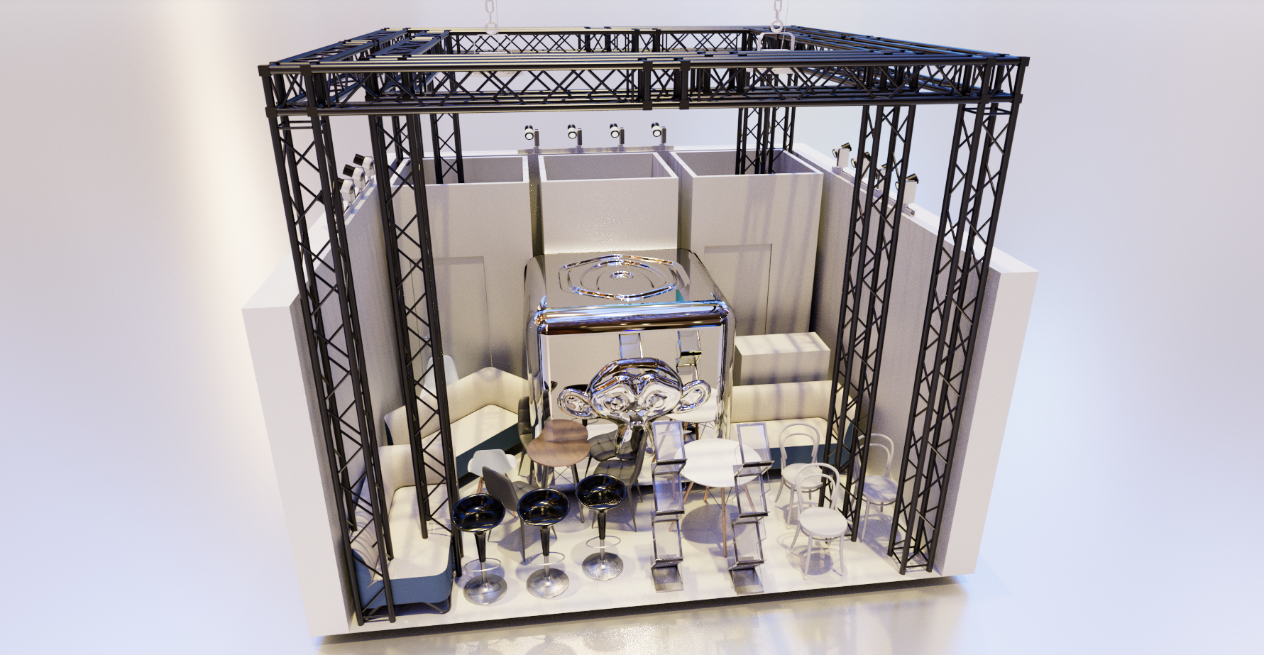

    #61324
    One more variant (light tracing). Renders much faster.
    https://v3d.net/g8u
