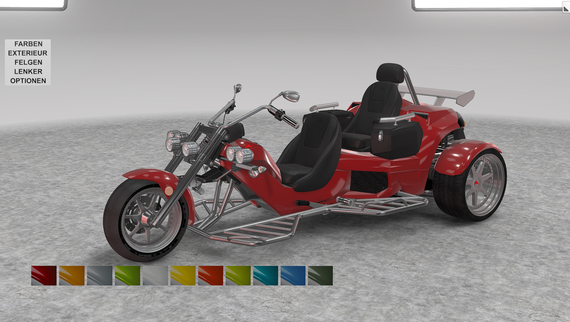

    hi Guys,
    i´m working on a konfigurator for trikes….
    I´ve im p´lemented a spherical Reflection Cubemap in to the scene…..
    It should reflect certain parts of the trike…..mainly teh colored mainframe of it….
    The color of it can be picked…

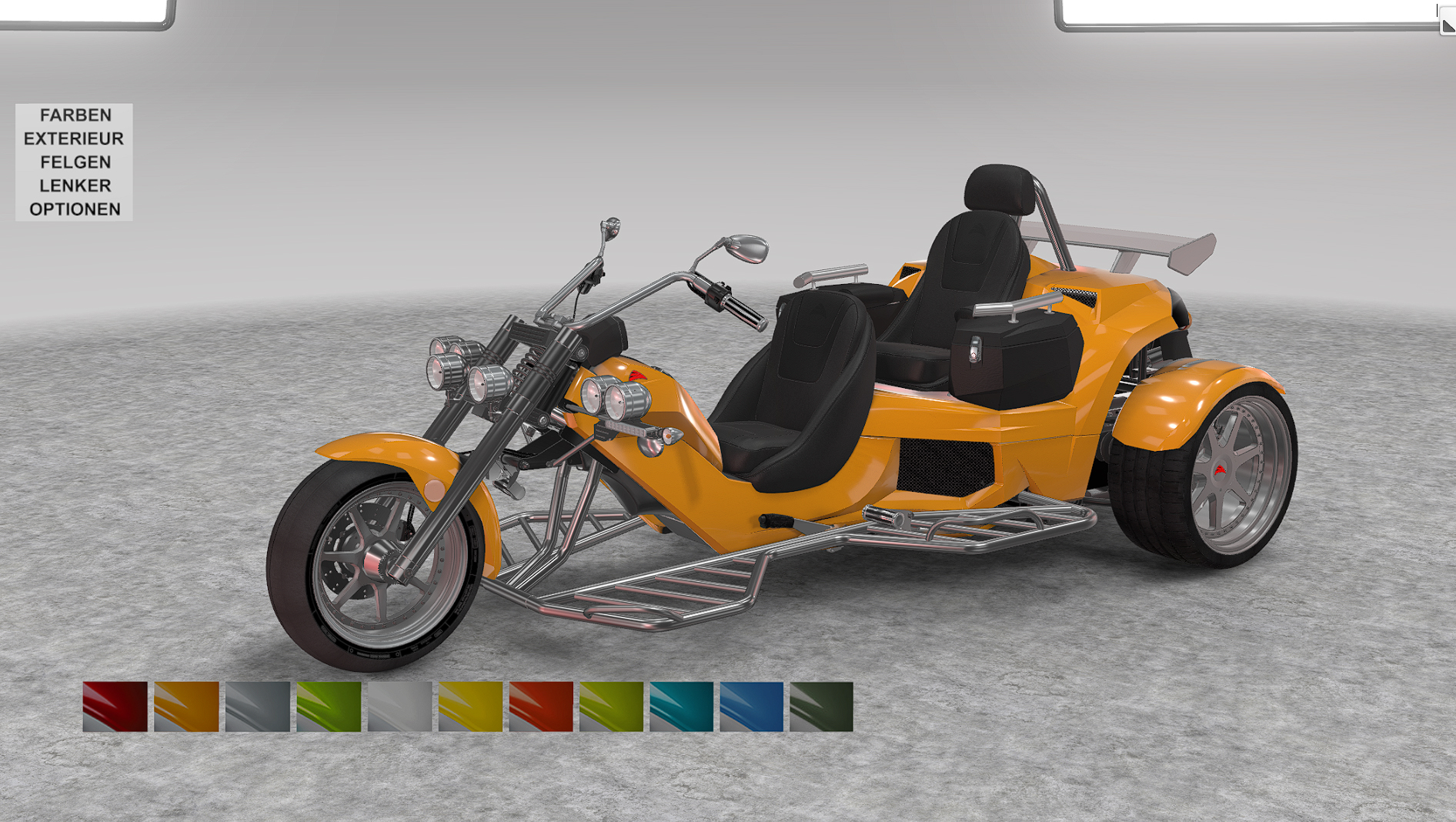

    At the start the color is red….as you can see in Pic 01
    In Pic 02 its yellow……
    Is there a way the lets say update in information to the reflection cubemap so it shows the right color in rhe reflections in the chrome material?
    Greets
    Ger

    here´s the first Pic 01

    Global cubemap affects all surfaces on the scene. However, you can add (or change) a colored HDR map on a per-object basis with Light Probes. Check out the “Custom Influence” property in the manual.
    #85410
    Still, It’s much better to change the material color :yes:
