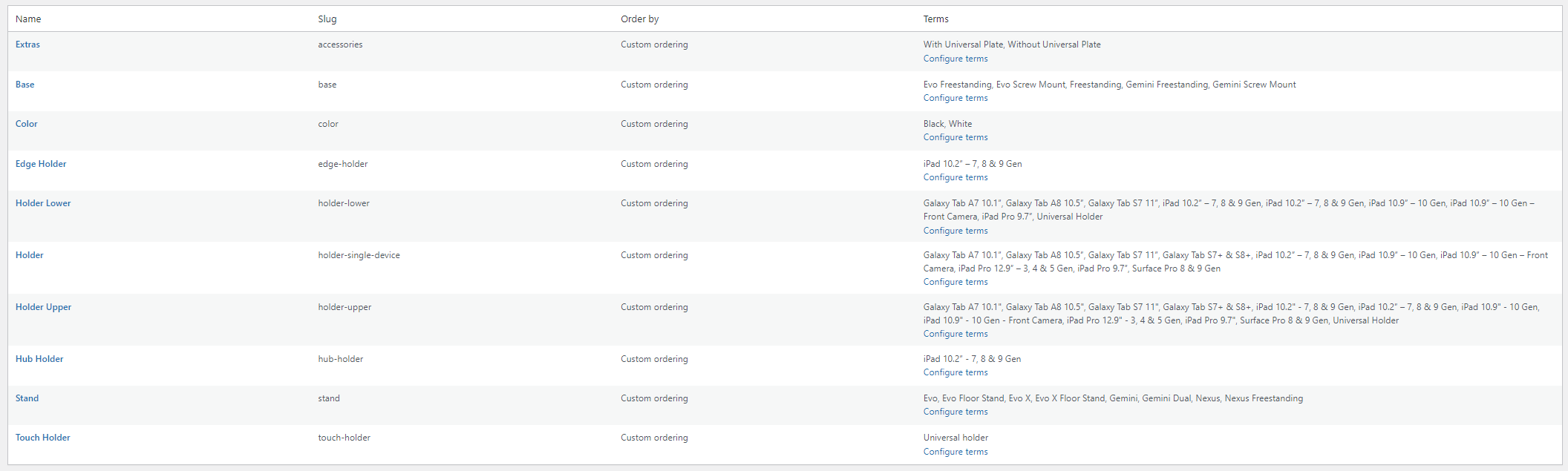

    I am looking to build a series of product builder pages using Verge3D and have successfully gotten it working on a drafting domain. However, I have run into an issue with the WordPress plugin unable to pick up the Woocommerce product attributes on the main site. As the pages have been built differently by a web developer, I suspect that I may need to create a HTML puzzle to pick up the attribute names elsewhere as opposed to how the Woocommerce puzzle does.
    I’m not very knowledgeable with code so it’d be helpful to see a puzzle example demonstrating how to do this.
    Here is a demonstration page: https://wordpress-780904-2967514.cloudwaysapps.com/product/test-copy/
    I’ve attached a screenshot of the attributes as well. Any help would be wonderful!
    Thanks
    Jin

    Hi, are you using some plugin to make your product configurable? If so, you definitely need to use some JavaScript to get product attributes. If no plugins are in use (just Variable product) you might want to debug the contents of the product info puzzle by printing it to the console.
