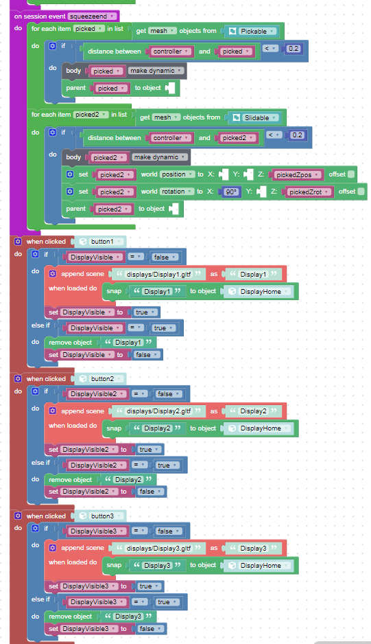

MicdsnCustomerI have a scene I use in VR where I load several GLTF fliles when a button is clicked on in the scene. If I dont ‘grab’ the imported models they will be removed at a second pressing of the button as the puzzle indicates, however if I pick up and move them, the second button press loads another instance of the model. What am i doing wrong?
(If you’re wondering why the two groups–the puzzle has 2 types of objects I want to interact with in the scene–‘slidable’ and ‘pickable’. I want some objects to be able to be moved, and some to be moved but ‘stick’ to the floor )

Yuri KovelenovStaff2024-10-31 at 2:08 pm #78354kdv
ParticipantWhat am i doing wrong?
your grabbed objects are parented to the main scene after releasing and already aren’t children of the appended scenes. thus they won’t be removed when you remove those appended scenes.

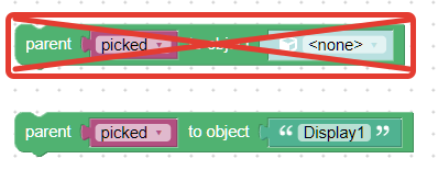

ParticipantIs there a way to parent it back to the main scene
they are already parented to the main scene. objects will be parented to
Sceneif you leave the second argument empty. But initially (before grabbing) they were parented toDisplay1.Puzzles and JS coding. Fast and expensive.
2024-10-31 at 4:52 pm #78366
MicdsnCustomeron ‘squeezeend’ I already parent it to an empty second argument. Is it possible to parent the picked object back to itself?
I’m thinking of giving up ‘removing’ the appended model and just hiding it. But if I cant call the object back by it’s alias to remove that might not be possible either.
To clarify–all i want to do now is just remove the object I loaded with the first click of the button. I used ‘append scene’ puzzle with an alias but I cannot ‘remove object’ on this alias if I have moved it at all with the controllers. — Everything works perfect if I dont touch the object at all with the controllers

Participanton ‘squeezeend’ I already parent it to an empty second argument
and that’s the main question: why instead of parenting back to
Display1you’re parenting your objects to the main scene? The second argument empty =ScenePuzzles and JS coding. Fast and expensive.
2024-10-31 at 5:38 pm #78372
MicdsnCustomerI’ll have to figure out how to do it. There are a possible 3 different models that are able to be picked up. Trying to figure how to avoid excess drawn out logic to handle all 3 just to unparent from the controller.
2024-10-31 at 6:02 pm #78373kdv
ParticipantI’ll have to figure out how to do it
put them back from where you took them
2024-10-31 at 6:10 pm #78376
MicdsnCustomerBut there are 3 possible displays — how do i put logic for this in the grabbing?
2024-10-31 at 6:12 pm #78377kdv
Participantremember from where you took objects. use some variable (a dictionary) to save initial parent objects for picked objects.
