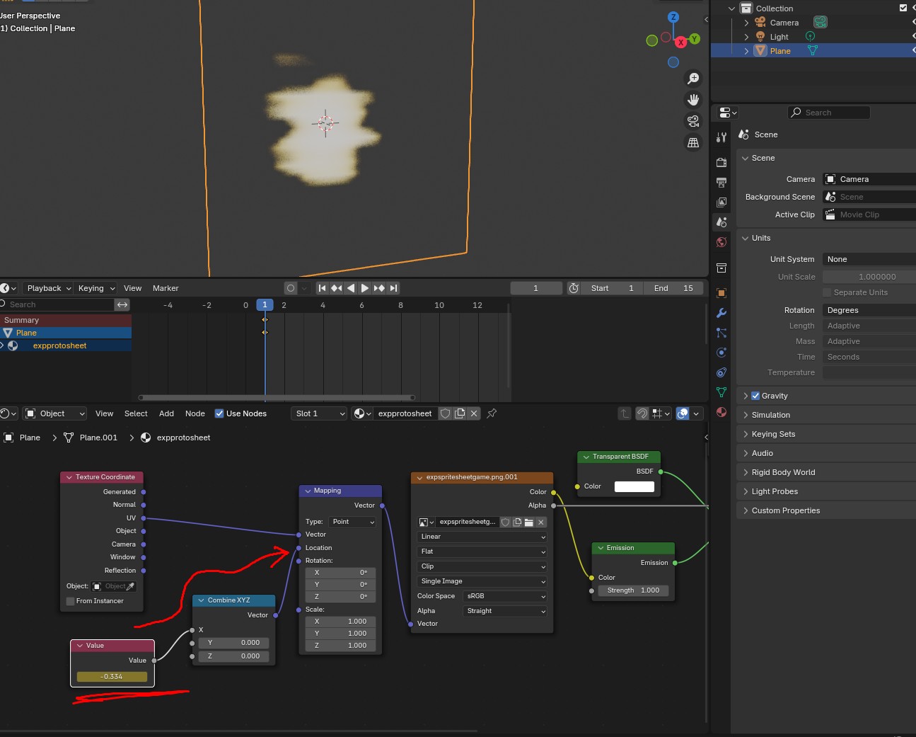

c4ccParticipantHow do I play this animation in verge3d? It works in Blender
Procedural nodes:
https://postimg.cc/N522xWN4Yet the animation won’t play in verge3d? How do I do this?
https://postimg.cc/ZBLCWm5JVerge3d files as attached

Mikhail LuzyaninStaffYou need to do it like this.
Using value node instead of direct Mapping node animation.-

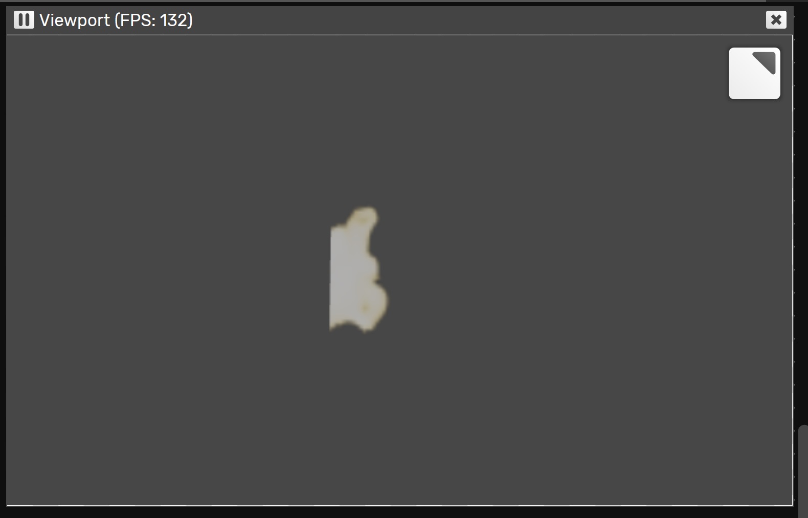

c4ccParticipantI tried, but the sprite sheet ran right to left:
How to get the sprite sheet to animate instead of running?

c4ccParticipantI tried, but the sprite sheet instead ran right to left like a slideshow:

c4ccParticipantOn second thought, I now can play spritesheets in browser.
While this works, what Mikhail forgot to mention was an intepolation as here, as kdv mentions below
Using value node instead of direct Mapping node animation.one more thing I feel essential part of this animation is to make the interpolation between keyframes constant
Looks like you didn’t notice that moment in both videos…
by doing these steps
1)
https://postimg.cc/67VkRGgrkeyframe values while clearing keyframes under location, mapping
2)
https://postimg.cc/7C6zJjKN3)
Interpolate constant while all keyframes are selected-
