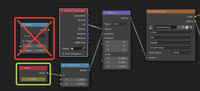

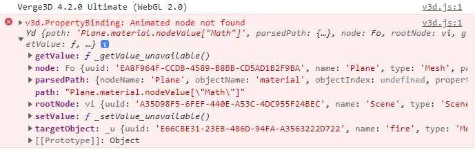

    What am I missing in this ? I tried the ways shown in tut. did I miss snything?
    even sneak preview doesnt show flame animated.
    here is a scene file – https://drive.google.com/file/d/1nUFYZkyJ2w5T6J4IzntN0VDd1BH8gKSo/view?usp=sharing
    #66075
    Do not animate “Math” nodes or any other nodes except “Value” nodes.
    https://drive.google.com/file/d/11xegNFuXI7sZOOdQqPaQyGALR8yZQsFE/view?usp=sharing

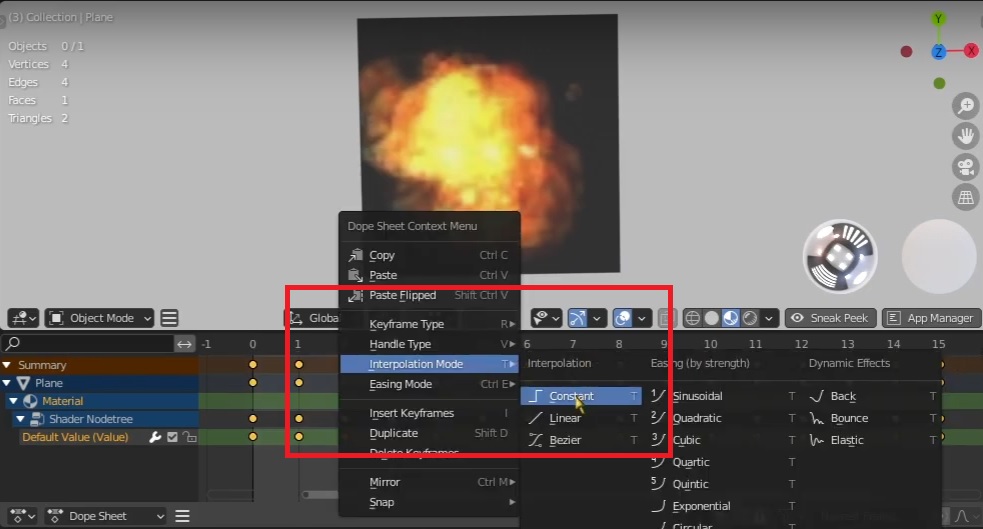

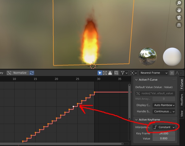

    one more thing I feel essential part of this animation is to make the interpolation between keyframes constant.
    Else it appears like sliding image sequence instead of animated image sequence.
    #66080
    Looks like you didn’t notice that moment in both videos…
