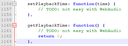

I tried the above i can be able to get only the full duration of the audio file from get duration puzzle. I am not able to get the exact playback time of the audio file from get playback time puzzle. Is it any way to check the playback time of audio file (current time stamps) ? or after 5s or 10s of audio file time?2025-03-28 at 4:31 pm #80967kdv
Participantlooks like the puzzle is not working at all

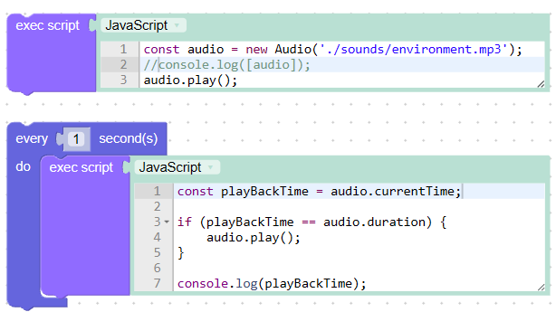

2025-03-31 at 4:44 pm #81000riya
Customer@kdv I tried above code. It’s not working for me. I have a mp3 file playing with sounds like attached puzzle. In console playback time is not working like above example. Am i doing anything wrong with above example ?

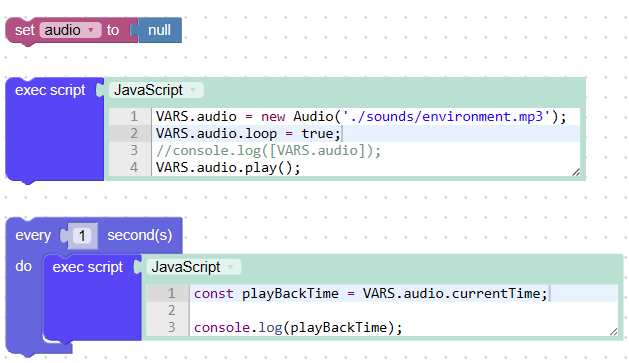

2025-03-31 at 4:54 pm #81002kdv
ParticipantAm i doing anything wrong with above example ?
I suppose you are using the standard “exec script” puzzle. it cannot access variables directly from another puzzle instance.
With the the standard “exec script” puzzle it should look this way

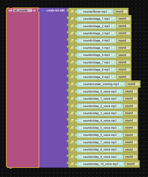

2025-03-31 at 7:26 pm #81004riya
Customer@kdv If i created the mp3 files like attached file in create list. Is there any different way to exec an Audio script?

2025-03-31 at 10:16 pm #81009riya

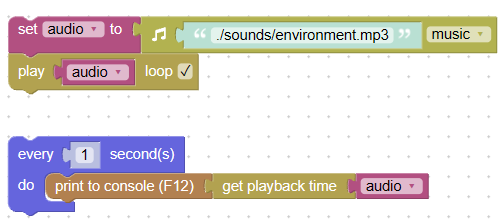

Customer@kdv Instead of single mp3 player like the example you shared environment.mp3. My team playing n mp3 files for n steps. we created a list using variable. Each mp3 player will play according to steps in given text .so we like to get exact current mp3 playback time for each step. Instead of single player mp3 player like environment.mp3.Is there a way to initialize a variable in EXEC SCRIPT to play the file from sounds folder containing n number of mp3 files?
2025-03-31 at 10:18 pm #81010kdv
Participantsee the post above. use “music”. it’s working.
2025-03-31 at 10:35 pm #81011riya
Customer@Kdv Its working. Thank you so much for your help.
