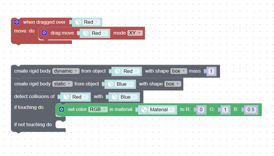

    Iv been trying to get the “Detect collision” puzzles to work. I just cant figure what im doing wrong. Im not able to detect a collision no matter what.
    Attached is a screen shot of the puzzle and the blend file. Can you please help me understand what am i doing wrong ?

    Looks like you didn’t add the core puzzle for the physics engine.
    Btw, dynamic bodies cannot be dragged…

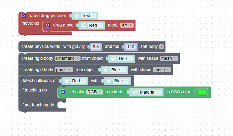

    jasonod888
    ooops…Added the core puzzle and then tried all rigid body options. Only Ghost works for dragging i guess.

    I’m able to detect collision using Ghost.
    Is there a way to have the objects just stop on collision ( not pass through each other ) ?
    The body is being moved by dragging it.
