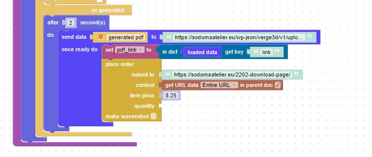

CustomerHi, I updated my apps to Verge3D recently and the email sending setup has crushed. It was working perfectly before, but some changes was made to the “place order” puzzle and it crashed. The case is very urgent, because the application should be published for the client already.
The process that was working:
1. The PDF was generated by CyberFox plugin.
2. The generated PDF was sent to the server via “send data” puzzle.
3. The order was submitted via “place order” puzzle.

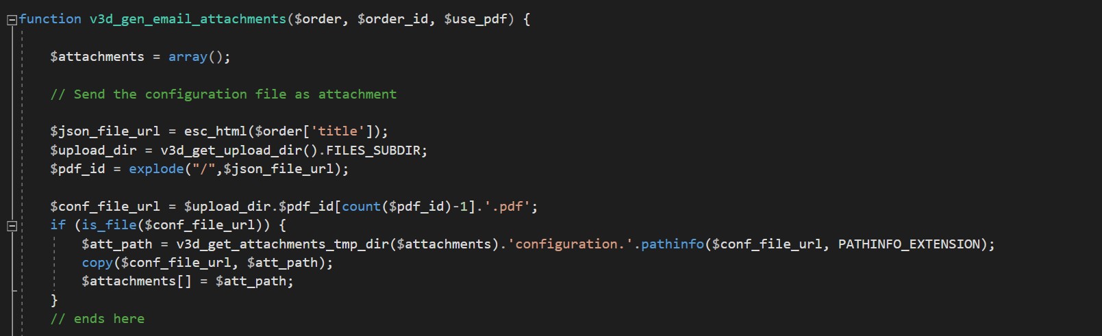

4. The special code was added to public_html/wp-content/plugins/verge3d/order.php$json_file_url = esc_html($order['title']); $upload_dir = v3d_get_upload_dir().FILES_SUBDIR; $pdf_id = explode("/",$json_file_url); $conf_file_url = $upload_dir.$pdf_id[count($pdf_id)-1].'.pdf'; if (is_file($conf_file_url)) { $att_path = v3d_get_attachments_tmp_dir($attachments).'configuration.'.pathinfo($conf_file_url, PATHINFO_EXTENSION); copy($conf_file_url, $att_path); $attachments[] = $att_path; }just after
function v3d_gen_email_attachments($order, $order_id, $use_pdf) { $attachments = array();5. This way, the user received the generated PDF as an attachment to the email.
But now, when I do exactly the same in new Verge 3D 4, it doesn’t work.

Alexander KovelenovStaffHi, please update WordPress plugin to new version 4.1. The code should be modified to reflect new orders APIs.
$json_file_url = esc_html($order['items'][0]['title']); $upload_dir = v3d_get_upload_dir().FILES_SUBDIR; $pdf_id = explode("/",$json_file_url); $conf_file_url = $upload_dir.$pdf_id[count($pdf_id)-1].'.pdf'; if (is_file($conf_file_url)) { $att_path = v3d_get_attachments_tmp_dir($attachments).'configuration.'.pathinfo($conf_file_url, PATHINFO_EXTENSION); copy($conf_file_url, $att_path); $attachments[] = $att_path; }On the plugin settings page you should enable Quote (or Invoice) attachments, because only this way the v3d_gen_email_attachments() function will be executed.
