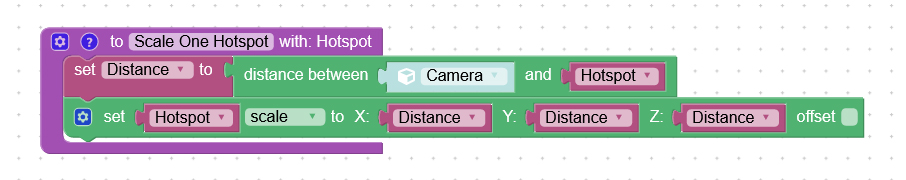

ParticipantSo, I’m creating a Verge3D scene where you navigate around a train-cab via hotspots. These hotsopts are little circles that point towards the camera using a Track To constraint (for some reason copy rotation dnt work for me) and I used the puzzle logic below to keep them the same size on screen no matter how far away from the camera.
The probelm is – at the edge of the screen they get larger. By quite a bit. The camera is quite wide angle as it’s a cramped enviroment.
Is there a way round this? I actually solved this in drivers https://www.youtube.com/watch?v=iq2l8EAiGvg&t=989s but its kind of a clunky solution which probably wont work in verge 3D and I currently have 10 hotspots which is a lot of extra empties to control all that.
Is there a way I can read the screen position of an object?
2022-04-25 at 10:16 am #51350
Mikhail LuzyaninStaffCreate an HTML element with the text and bind it to an empty it’s will be easier. Otherwise you need to do some recalculations to set scale based on distance not only use pure distance as scale.

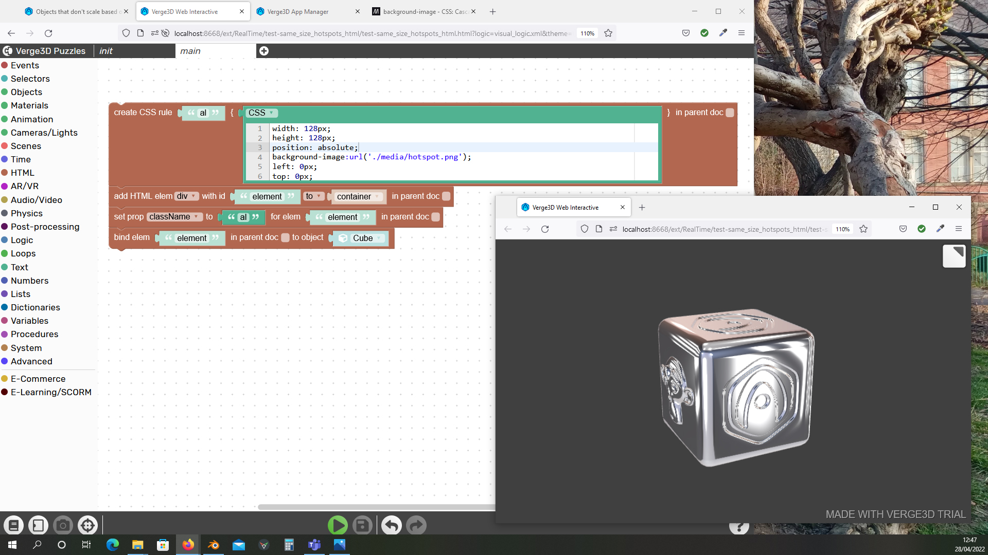

2022-04-28 at 11:55 am #51443yogyog
Participant………..I’m not getting anything.
WHile it was really kind of you to upload the video, you uploaded it at 480p, so I’m not totally sure this is right. I’ve uploaded a screenshot of what I have.
Also – I didn’t have the same options for Modules on the beggining as you. I had:
Font Converter
IE 11
Legacy VR
PhysicsCould this be a problem? I think I have the latest version.

2022-04-29 at 7:21 am #51473
Mikhail LuzyaninStaffYes, it’s must work. Share the app I will look what wrong.

2022-04-29 at 4:51 pm #51504
Mikhail LuzyaninStaffYou need to add . before “al’ in puzzle Create CSS Style, but only there. It’s important because all classes names must be named with ‘.’
2022-05-09 at 9:19 am #51827yogyog
ParticipantOK – thankyou for your help again and again – you’ve gone well beyond when it comes to your help with this, and I hope you don’t mind that I was away for a week, but ….
I have one more question to ask you.
It’s about cetering the button in the middle of the object.
I’ve added the line
background-position: center;
but it’s not …. centering it. It’s still with it’s top-left corner on the object centre, not the centre of the png on the object centre.2022-05-11 at 8:04 am #51899
Mikhail LuzyaninStaffYou need to set Left to half of the width px, and top to half of the height. For example if widht 250px then set “left: 175px;” etc
