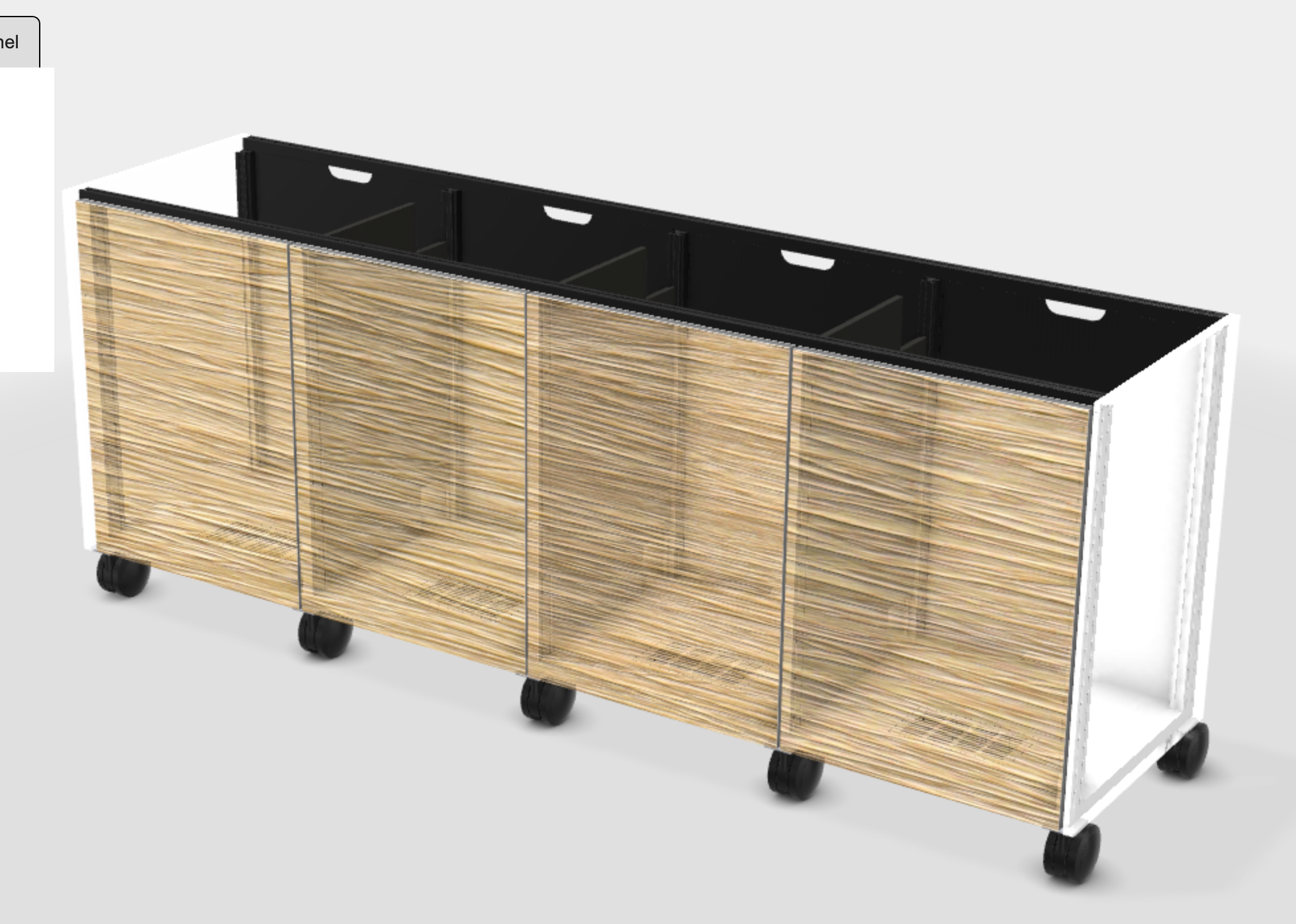

CustomerThis is a screenshot of a cabinet configurator, that for some reason is showing the doors as transparent, regardless of the material. I can swap out the door models, and all of them except one that I just added is also transparent. Other objects, like the countertop etc, are not transparent.
You can see it here: https://v3d.net/18p7

xeonCustomerWell…this one is interesting.
When I initially opened the project…. I was able to see many things that were transparent that should have been opaque. Side panels, doors, and things were transparent. I went through the blend file looking at materials and saw nothing glaring…. then noticed the project was using a different version of V3D than I was so I updated it. I am running 4.8.1. Refreshed and all the materials that were transparent before are now opaque as you would expect.What version of V3D and Blender are you using?

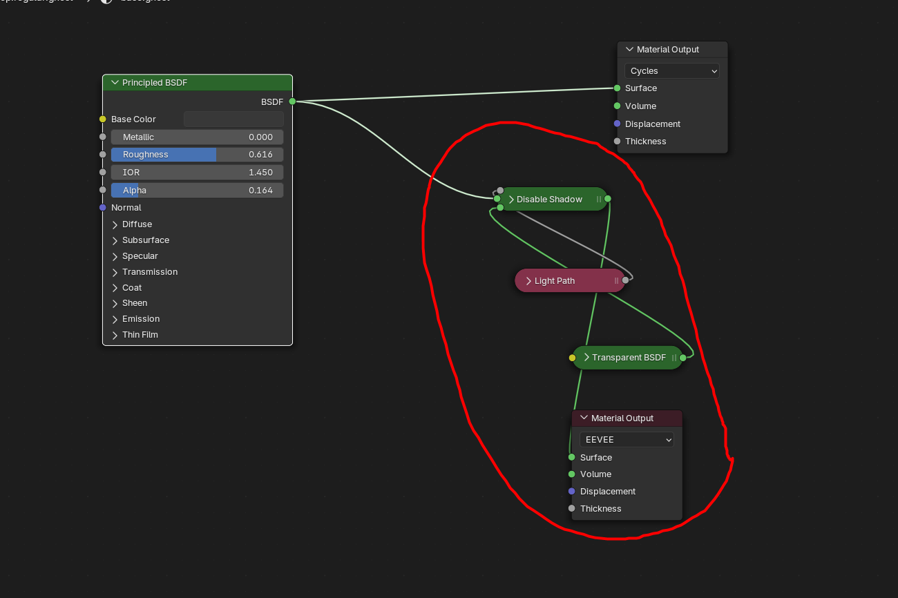

Mikhail LuzyaninStaffThis is because of this nodes. Blender adds them automaticly when you switch from 4.2 (and lower) to 4.3 (and highter) version randomly (on my opinion) choose a material.

I was using Blender 4.0 and verge 4.7.1. I have upgraded to 4.4.2 and 4.9.2, but now the exported gltf doesn’t load at all. The other scenes load without transparency issues, but I don’t remember what version they were exported from. I tried 4.2 also, but that didn’t load either. So recap: exporting from 4.0 has weird transparency, 4.2 and 4.4 don’t load at all, in either verge 4.7.1 or 4.9.2. I tried 3.3 but it crashes when I open the blend file.Mikhail:
