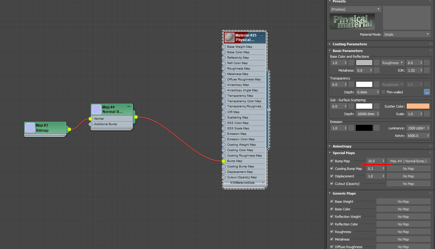

    Hello
    for some reason i can t get my normal maps not working
    Using 3ds max 2023 with ART render and physical materials – see screenshot
    Even bumping the value up to 100 doesn’t shows any difference

    3ds max allows to set it only maximum as 10, and it must be set in matrial parameters.
