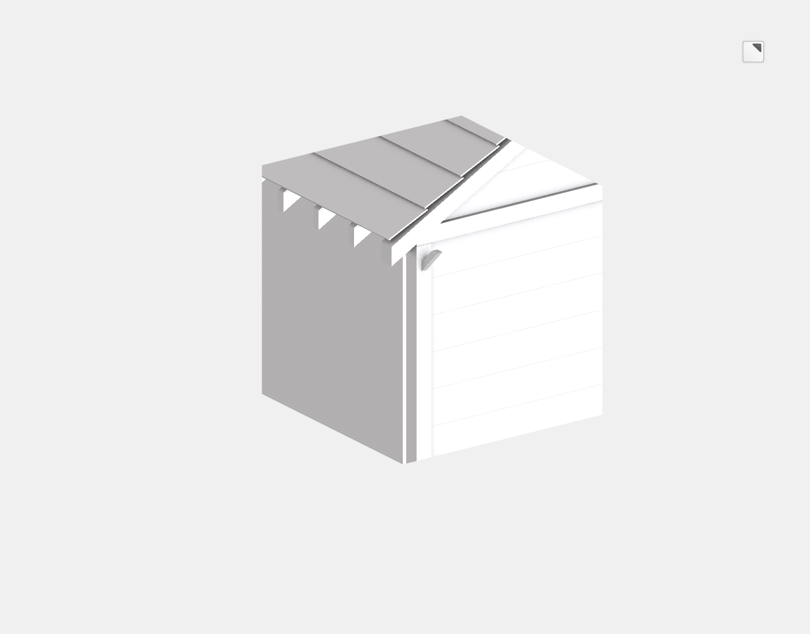

    Just to add to this, I’ve added a new cube object and it now allows the scene to be rendered but only inside the bounds of the cube. See attached screenshot
    #87962
    sbs
    Another piece of info, when disabling ambient occlusion only the cube itself is rendered and no longer acts as a “window”
