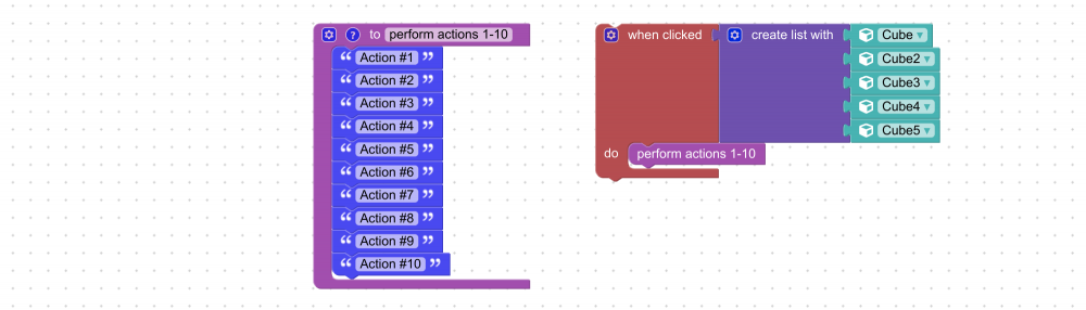

Too much copy-paste in Puzzles
Say you need to perform 10 different actions for 5 objects on your scene. The most straightforward way to handle this would be just using copy-paste:
Too many puzzle blocks
However, such a scenario is really hard to maintain. It also slows down the Puzzles editor. Instead, you might employ procedures that will make your scenario way more compact:
Less puzzle blocks
Also, by using lists you can simplify the logic even further:
A few puzzle blocks
It's definitely worth spending a little time to learn these two techniques, since it may save you many hours later.

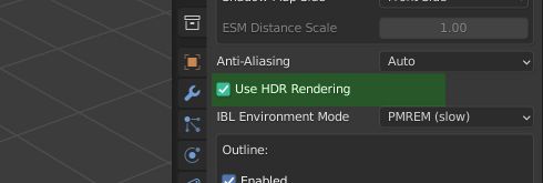

Enabling HDR Rendering when not required
Use HDR rendering property enabled in Blender
Activating this feature causes excessive GPU memory consumption and rendering slowdowns. You still can use it in the following two cases:
  • If you are using Bloom post-processing effect.
  • There are procedural gradient nodes/maps in your materials.
Enabling HDR rendering will significantly improve the quality in both above-mentioned cases.
Contrary to popular belief, HDR rendering is NOT required for image-based lighting, even if it uses HDR maps.

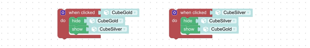

Swapping object on click
Say you need to replace some object by another one given they both occupy the same place, e.g swap CubeGold by CubeSilver and vice versa. Most evident way would be using two when clicked puzzles:
Incorrect puzzle blocks for swapping object on click
This won't work however since both events happen right after another. So the first event handler will switch to CubeSilver, then the second will switch back to CubeGold.
A possible workaround could be delaying the actions by one render frame:
Proper puzzle blocks for swapping object on click
Alternatively, you could swap your objects using just one when clicked puzzle:
Best puzzle blocks for swapping object on click

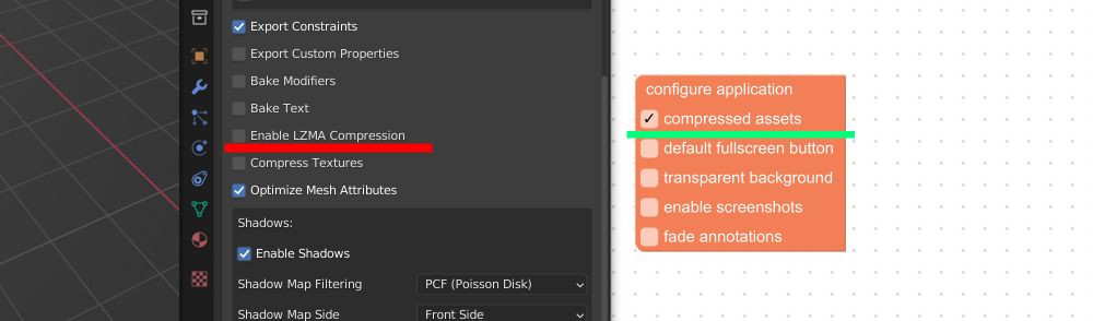

Forgetting to enable asset compression in the scene file
Say you enable asset compression in Puzzles but forgot to enable it in the modelling suite:
There will be one of the two possible situations as a result of this:
  • Situation #1 (bad). You won't be able to load your scene, since your app expects the compressed asset (e.g my_awesome_app.gltf.xz) which is unavailable. As a result the app preloader will freeze forever.
  • Situation #2 (even worse). You have file called my_awesome_app.gltf.xz in your app which you exported earlier. As a result it is now out of sync with the uncompressed version (my_awesome_app.gltf), and so with your source scene (.blend/.max/.mb). You will have hard time trying to figure out why Verge3D rendering no longer reflects the changes you make in your scene.

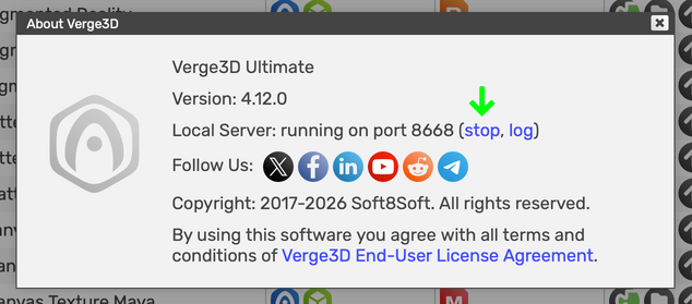

Switching system user when App Manager is running
Essentially, App Manager uses background web server process attached to the particular user. Even after you perform a log out, this process stays as is and will prevent another App Manager session to be started. This might cause real confusion and various unpredictable bugs. Always stop the App Manager (via About dialog) before you switch the user. If you missed to do that, the most clean solution would be restating the system.
