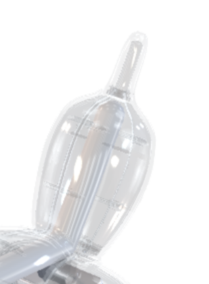

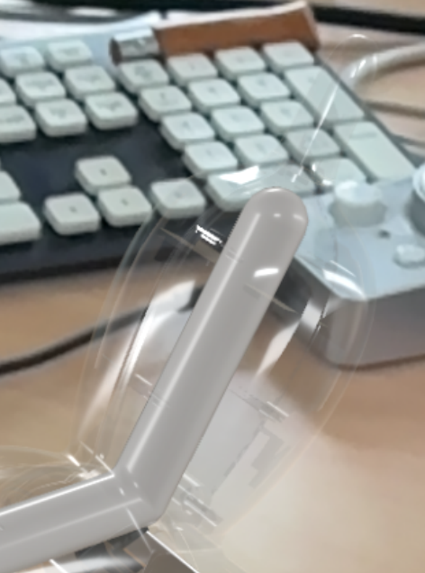

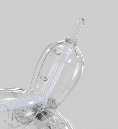

    I need help for plexiglass / glass shader for AR, on iOS, so i guess Physical / USD shader.
    I’m aware that i’ll never reach the rendered effect, but as you can see in pictures, even if the white background verge3D is quite ok, the iOS AR is very…. “thin-walled” instead of… glass.
    I must admit all alpha modes, depth write and OIT stuff i don’t understand…
    Any help would be great !

    the Web render suits me, it is quite close to actual render. But the iOS’ AR is way too “thin”
    #82208
    Unfortunately, since we must convert the loaded scene to USDZ format, such discrepancies are not avoidable. Basically, how to display transparency, is entirely up to the build-in iOS renderer. You might increase opacity or add some other geometry before entering AR mode to compensate the lack of transparency.

    NaxosCG
    I think the problem is worse than just 2-sided lack in iOS’ AR
    Please see my screenshots :
    one is within web : all ok, we can see interior parts
    In the AR screenshot, it seams that interior parts are hidden. The trenchs are bleu and visible, but the flat part is… simply not there.
    Of course i’ve double checked normals, and no object is hidden before sending the scene to iOS’ AR
    Maybe some Apple’s transparency optimization that makes objects behind others to not been rendered ?
