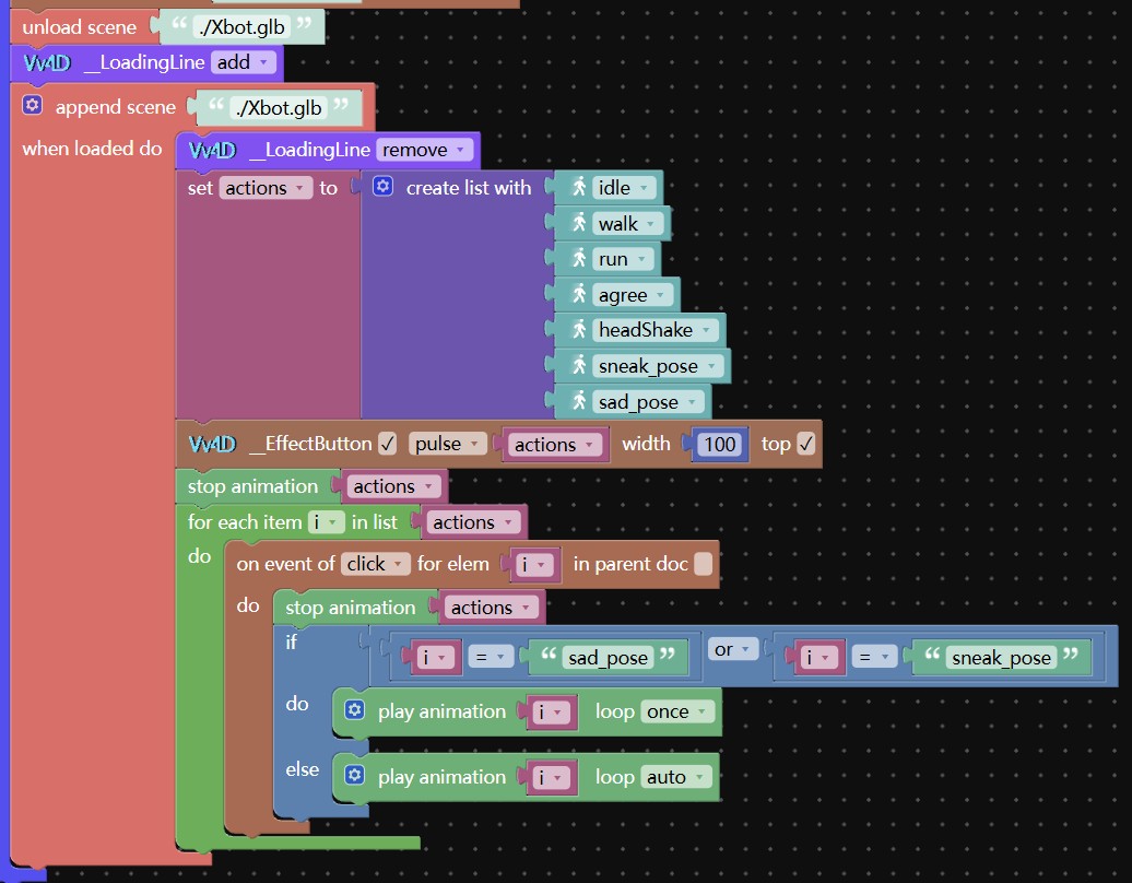

QiangGeParticipantIs it possible to have two separate actions for the same armature? Like in Blender I can assign two separate actions to the armature. It would be sweet if I could access these in
Hi,maybe try this demo
tip:Characters with multiple actions can be exported to glb files using Blender’s built-in export function.
If you need to control character movements, achieve natural transitions between multiple actions, enable physical collisions with the scene, switch between first-person and third-person perspectives, etc., you can try this demo.2025-08-13 at 9:24 pm #84169adamabr
CustomerThanks for the suggestion Qiangge! I got it to work which is awesome! I can play specific actions independent of each other.
However, looking at the performance log I can see that the draw calls increase with the number of bones. It almost seems like the built in glb exporter separates the object into one object per armature bone. This is a bummer, as my main use for this was to combine objects and materials to reduce the number of draw calls in the scene. If I get the same amount of draw calls with this method, as if I had separate object I don’t see the point in using it in my case.
I really appreciate the input though, thanks again!
