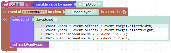

2023-01-16 at 2:02 pm #59609liranhersh
Participantthank you, I tried to make the puzzle but few problems I have:
1. can’t find the puzzle “setTrackPointPosition” in the menu.
2. the exec script show a problem with the code, do you know why?thank you for helping me :)

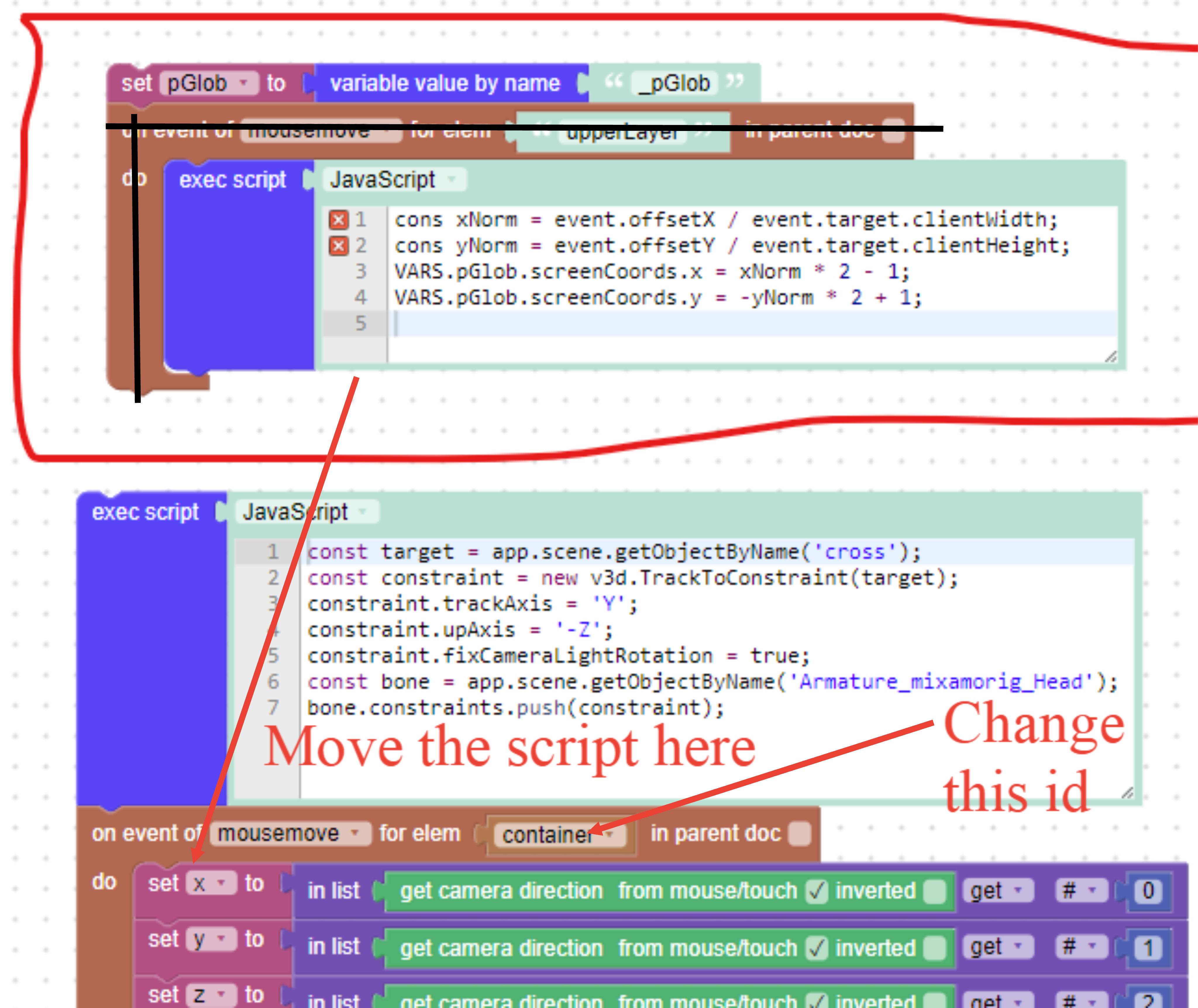

2023-01-16 at 9:00 pm #59625kdv
ParticipantDo not make typos.
constmeans a constant,consmeans nothing.1. can’t find the puzzle “setTrackPointPosition” in the menu.
It’s a prosedure. You dont need it. Just move the scrip to the existing event listener. Do not create a new one.

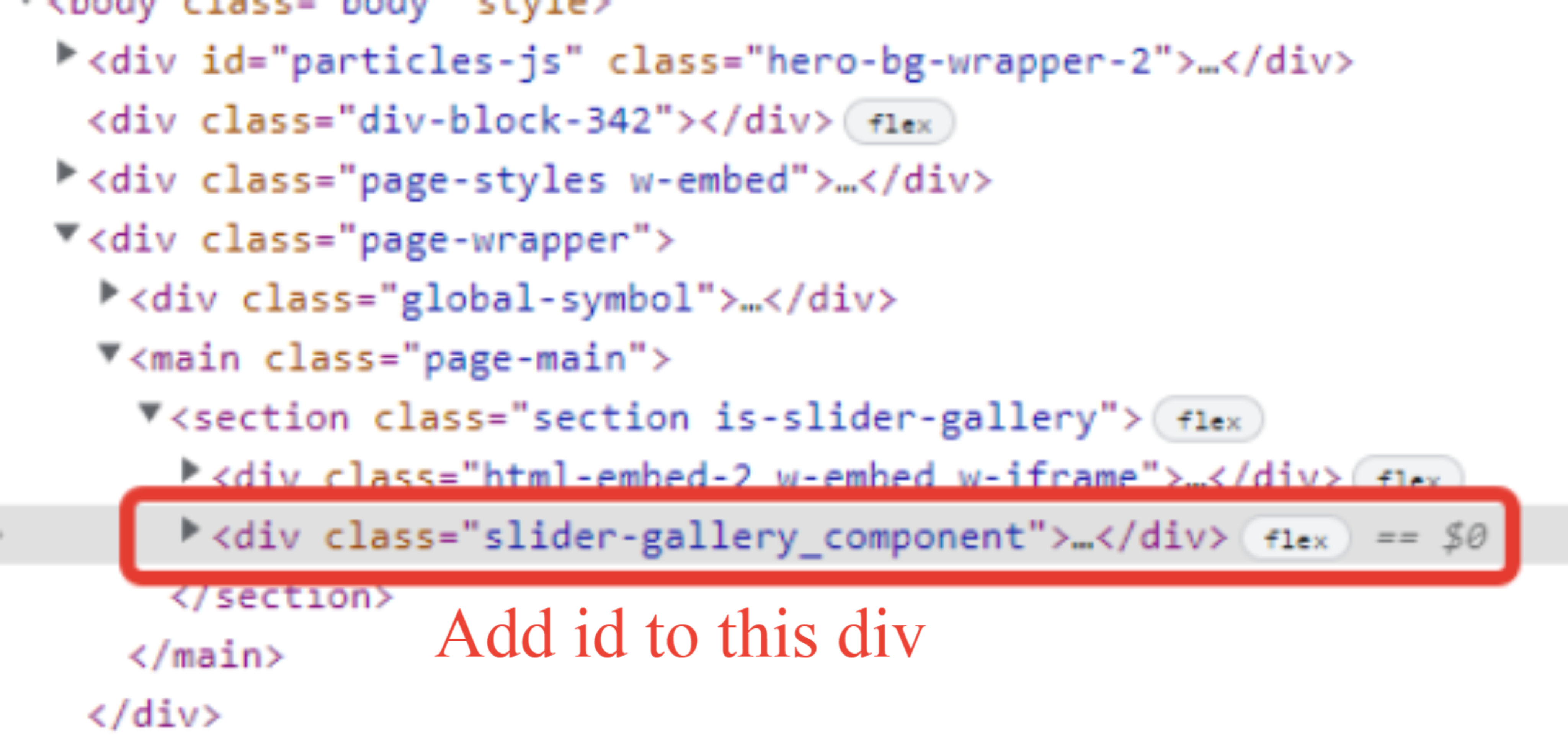

Add id to your upper layer div and replace
containerby this id. Enablein parent docoption.
2023-01-23 at 3:35 pm #59766liranhersh
Participanthi,
thank you man, I tried do it by yours steps.
I had the screenshoot of the puzzles.
in the website I gived an ID to the div you write.still not working, can you tell me why please?

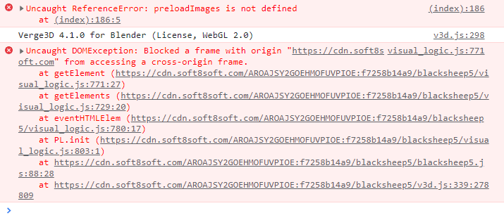

2023-01-23 at 3:48 pm #59769kdv
Participanterrors

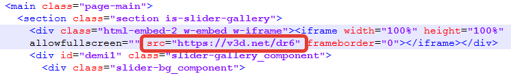

2023-01-23 at 4:26 pm #59773kdv
Participantthere is a problem with the puzzle?
there is no problem with puzzles. the problem is with your .html files. Your
iframe srcleads to another site (a cross-origin iframe). Generally it’s not allowed. That’s why it has been blocked. At least, JS code can stop working.
Share your app folder…I NOT developer, what I need to do to fix it please?
So what? you’re trying to create a site based on HTML and JS. Read a little about these instruments. Google knows nearly everything )))

2023-01-23 at 5:43 pm #59778kdv
Participanthere is the problem with your iframe: wrong
iframe scr
copy you blue sheep app’s files into the root folder of your site ( where index.html is), replace
https://v3d.net/dr6byblacksheep5.html.Puzzles and JS coding. Fast and expensive.

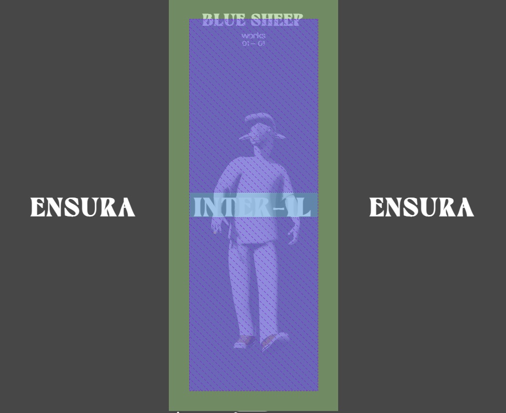

2023-01-23 at 6:13 pm #59780kdv
ParticipantIn your case it’s hardly possible to implement this feature working properly. There are blocks in the parent document with the width equal to 1/3 of the window width.
