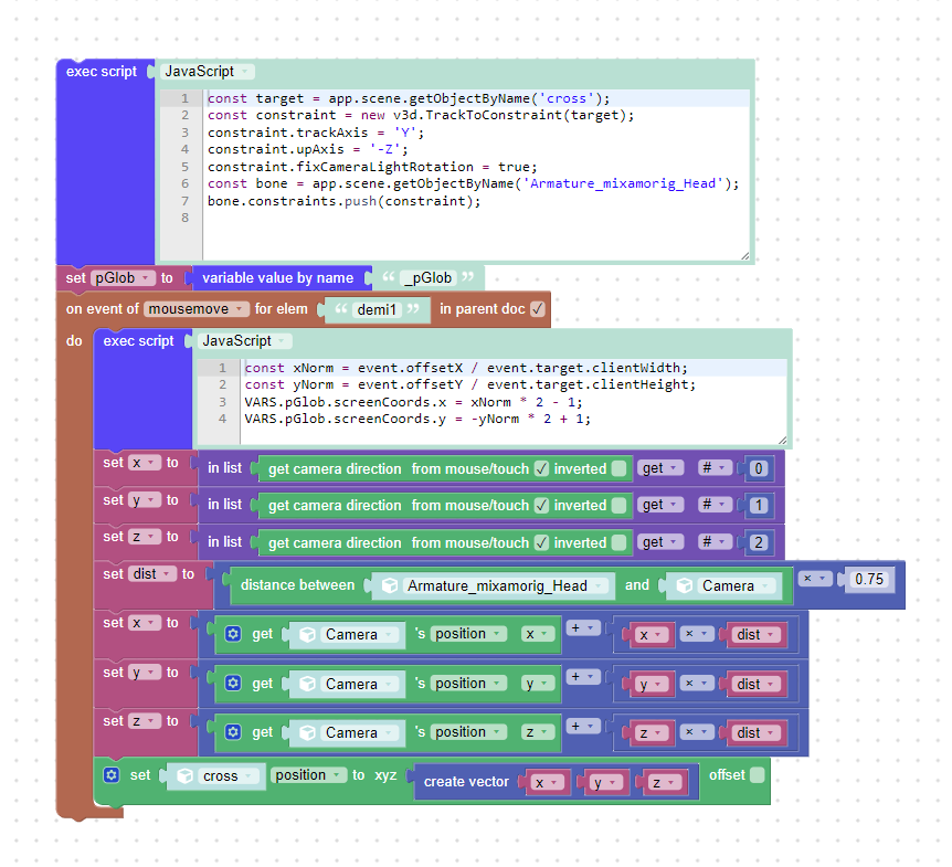

    #59564
    https://v3d.net/dqv

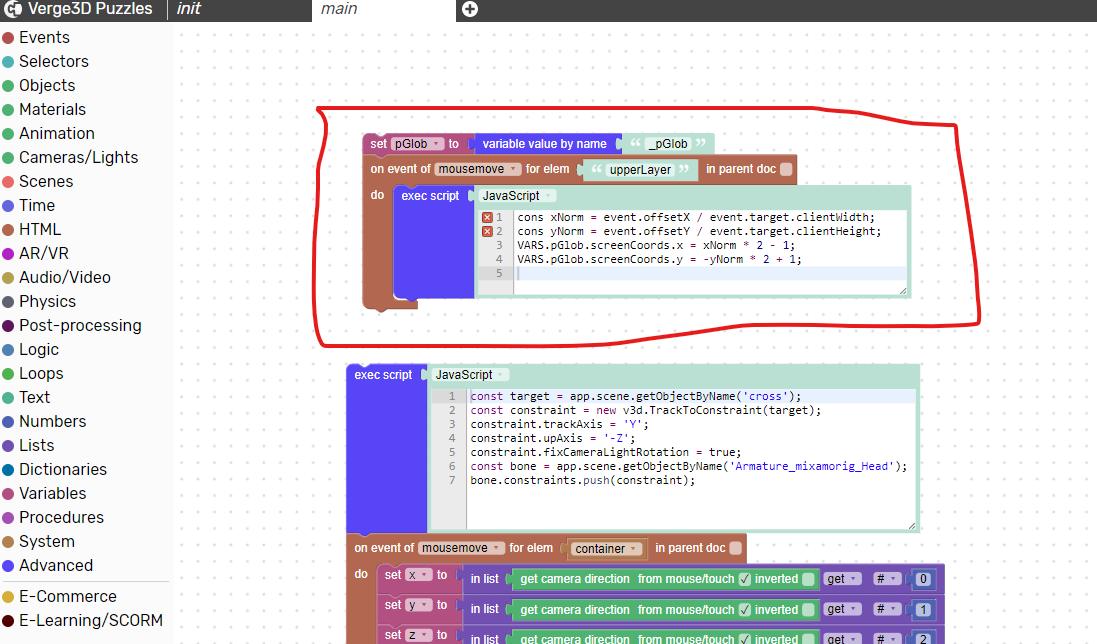

    #59609
    liranhersh
    thank you, I tried to make the puzzle but few problems I have:
    1. can’t find the puzzle “setTrackPointPosition” in the menu.
    2. the exec script show a problem with the code, do you know why?
    thank you for helping me :)
    #59625
    Do not make typos. const means a constant, cons means nothing.
    It’s a prosedure. You dont need it. Just move the scrip to the existing event listener. Do not create a new one.
    Add id to your upper layer div and replace container by this id. Enable in parent doc option.
