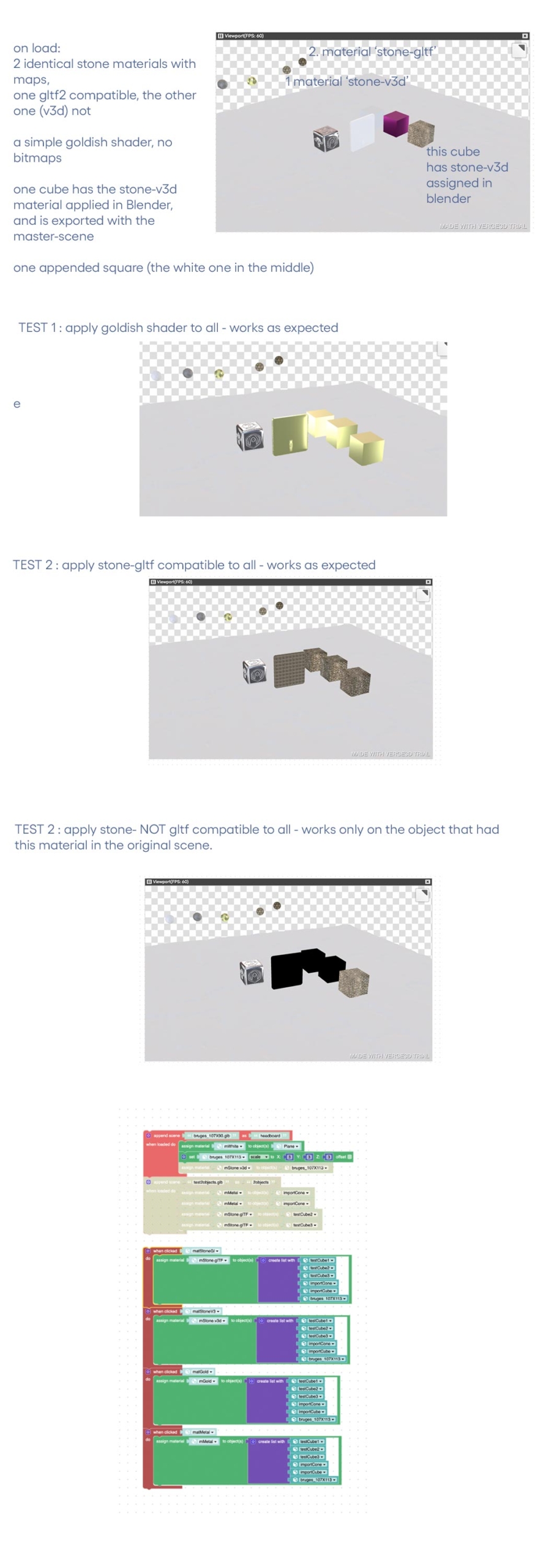

    The last project was in v4.2: I made a huge configurator (800 objects, 40 materials, 300 billion configurations).
    In v4.2 I could append scenes and assign PBR materials to them with no trouble.
    The company I worked for, no longer does that production, so I’ll go freelance. I’m brushing up my Verge-skills, and in 4.6 trial: I can no longer assign materials with maps without making them glTF compatible.
    If I assign a PBR material to an object, the object turns black. If I assign a copy of the PBR material, that has been checked as ‘glTF 2.0 compatible: the material is shown on the object.
    The only case on which the standard material is applied, is when the object is loaded with a pbr
    I checked my files from last years project, and none of the materials were set as glTF-compatible
    I usually code directly in the visual_logic.js, but for small tests, I quickly set up some puzzles, so, I added a screenshot

    thanks, disabling the ‘optimize mesh attr.’ worked for the cubes in the masterscene. Not for the appended geo that worked in a v3d 4.2 project. I’ll have a look at it this weekend.
    #75635
    kvdml
    just did a quick test: the imported object does not get the pbr material assigned when it’s a standard glb. A v3d glb version works.

    It would be nice if in future versions we could decide ourselves what mesh attrs could be optimized: the optimized mesh attr. version is comparable with a plain glb in filesize (696kb uncompressed, 219 kb with xz compression). Too bad it’s not compatible with v3d pbr shaders with maps.
    This optimization is basically removal of Tangent attributes (needed for normal mapping) which require 4 additional float values per vertex. Perhaps we should consider making per-mesh setting instead of the global one. For now I might suggest making two scenes: one with normal mapped shaders and models which require tangents. Another which don’t require them.
