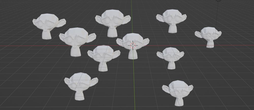

Case #1 - Ten low-poly Suzanne models
The first scene contains 10 Suzanne models. We did not shared meshes among these models, so for the exporter the scene appears like having 10 different geometry blocks. In total, there are approximately 10 000 triangles.

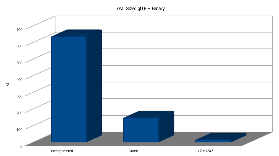

Here is what we've got by exporting it to the gltf+bin format.
The results are quite shocking. Verge3D's native compression algorithm beats Draco by a factor of 10! Remember we had 10 models on our test scene and LZMA can handle this situation quite effectively.

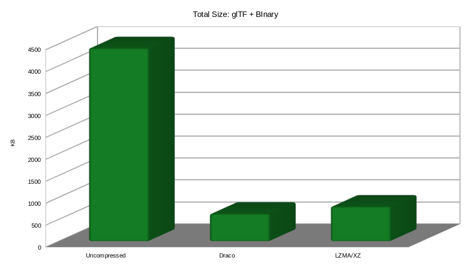

The second scene contains 1 middle-poly Suzanne model. In total, there are approximately 62 000 triangles.
The results are kinda different:
Now Draco beats Verge3D, but the margin is not so big, approximately 20%.

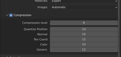

In typical scenarios LZMA and Draco have comparable compression levels, but... Draco applies compression with loss of quality. That means, that in some situations, you we'll be required to manually tweak attribute precisions which is not quite straightforward for non-coders. Check out the Draco params from the Blender glTF exporter:
There are so-called "quantization" params which define quality of the exported attributes. Basically, higher values give better precision, while lower values give better compression ratio.
