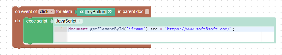

    I have an iframe on my page with id=”iframe”. I would like to have a page loaded when for example a button is clicked.
    for example: google.com should be loaded in the iframe.
    What puzzles do I need? Or do I have to witte custom code?
    Hope someone can help.
    #34090
    Hi, there’s no puzzles exactly for that, but you can use “exec code” like this:
    The code in the “exec script” puzzle is:
    document.getElementById('iframe').src = 'https://www.soft8soft.com/';
    Btw, there’s a restriction on what you can load inside an iframe, for example, google.com doesn’t allow to load its pages like that.

    Hi, there’s no puzzles exactly for that, but you can use “exec code” like this: iframe.png

    Do you load your verge3d application inside an iframe as well? That also may be the case. If true, then you need to change a little bit the code inside “exec script”:
    parent.document.getElementById('iframe').src = 'https://www.soft8soft.com/';
