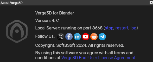

    App Manager: Your Verge3D for Blender Enterprise License is active. Verge3D for Blender Version: 4.7.1
    Blender Addon is 4.7.1

    As noted in my original post, the app manager says it is running the latest:
    AppMan
    So is my Blender add on.

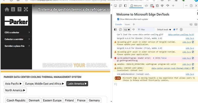

    I have external users reporting issues, this is a screen cap:
    cons
    How can this be resolved?
    Thanks.
    #78178
    Hi Jeff,
    Your Verge3D installation is fine and up-to-date. It appears that the engine library is still of version 4.6 and not activated by the license key. This can be fixed in the App Manager by updating the application, after which you better re-save the Puzzles also, and re-export the glTF files. Finally you’ll need to re-upload the updated app.
