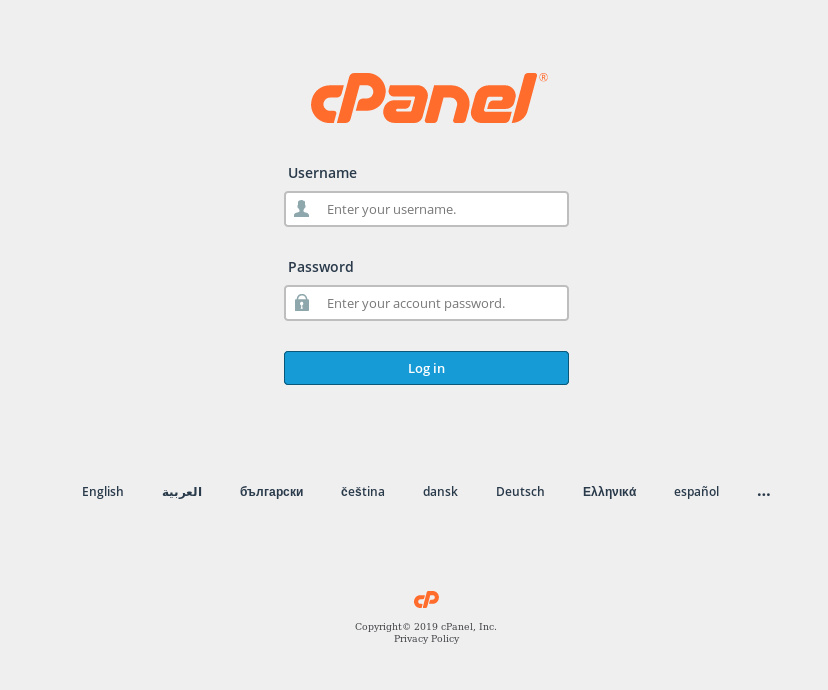

    I think this resource is password protected:

    chromebook15
    so,then how can i attach those png files to the site so that they can be manipulated? do i have to upload the images in some other way?
    how do i make the resource publicly available and modifyable?
    within the site i cannot set the permissions to “modify” only read.
