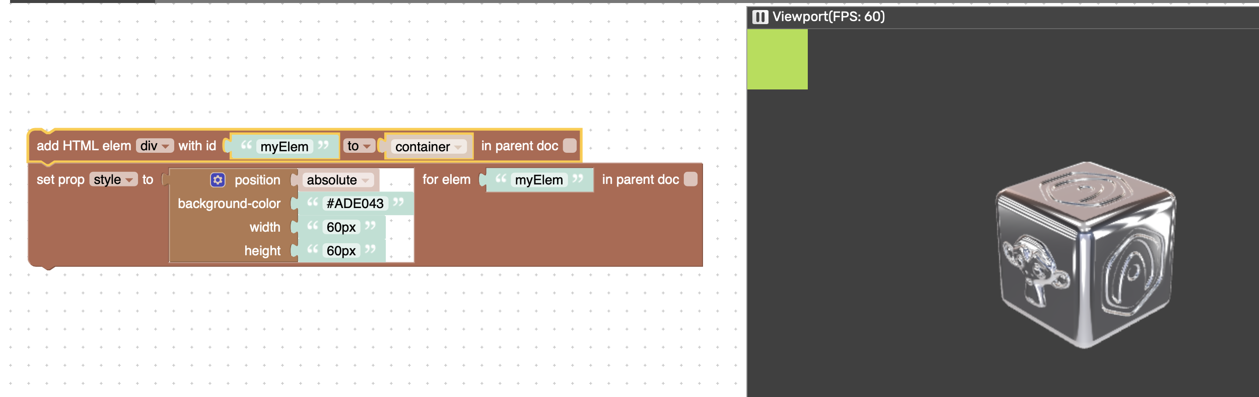

    Attachment 1. I created a div with id “myElem”

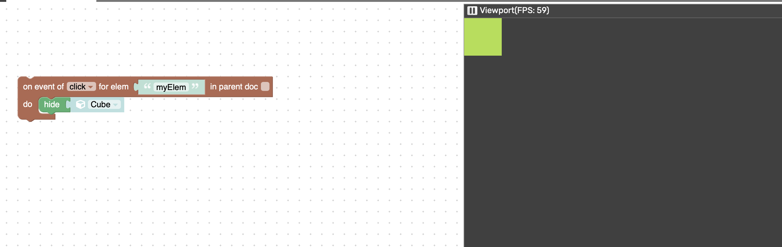

    Attachment 2. I created an event. Every time “myElem” is clicked, the 3D cube is hidden

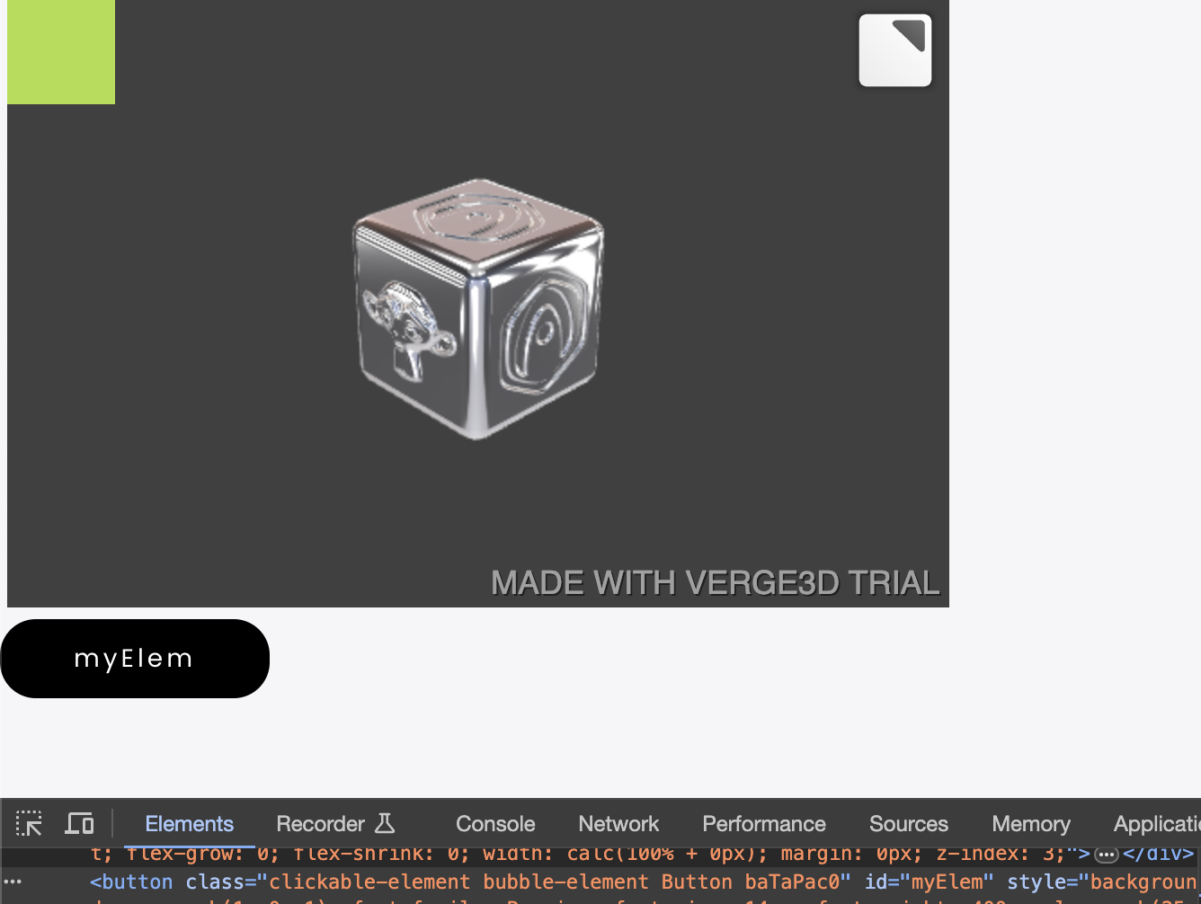

    Attachment 3. On the frontend, we have the iFrame and a button called myElem with the same id. When I click, nothing happens.
    How can I make it work?
    #75607
    Enable “in parent doc”.
