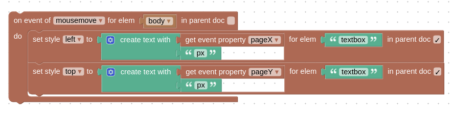

preferens.seCustomerI still can’t get it to work. I’ve made a test application here called “drag-move”.
I have (quite naively) simply placed a
[Set style top to] with a [get event property pageY] as input for element “textbox” in parent doc
and a [Set style left to] with a [get event property pageX] as input for element “textbox” in parent doc
inside a [every frame do] puzzle. This does nothing.Please open the .zip and see what I’m missing.
2020-08-13 at 3:57 pm #31510
Yuri KovelenovStaffSorry I was not clear and also made a mistake. Here is how it should be:
attached the Puzzles’ save file too:

preferens.seCustomerBrilliant! It works!
I’ll probably be using this in every project moving forward so thank you so much.
I added a little math to place the textbox next to the cursor. Otherwise it prevents the user to interact with the application. I also set it to only appear when the cursor hovers over the cube.
