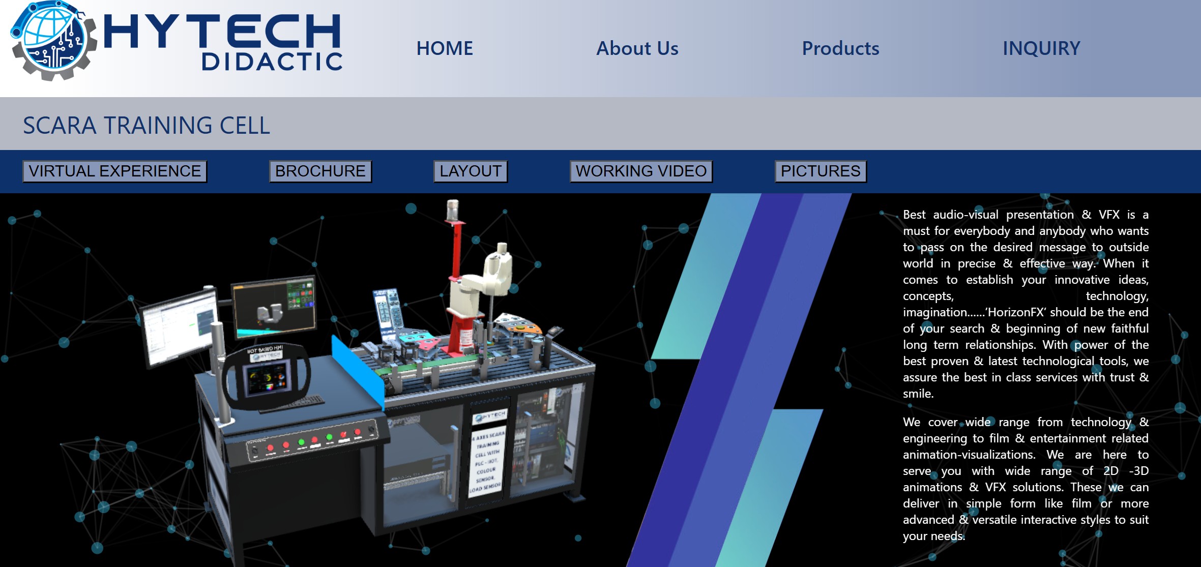

    Here is a screenshot of a website we made for out client with header page itself with complete robot system playing in loop infinitely. Shor clip is attached fyr
