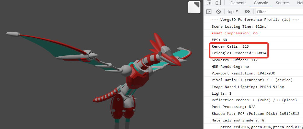

    Trying to eliminate problems like these
    #67972
    Your raptor alone takes up the lion’s share of render calls and tris rendered.
    All other meshes are rendered only if they are in the camera’s field of view.

    My current Performance Profile:

    In ideal, you can reduce geometry buffers and render calls for this raptor to just 5 (if you use bones for animations). The triangles count is not so significant.

    Your raptor consists of 76 separate meshes. One mesh with one material -> one geometry buffer and one render call. Some meshes are multi-material meshes. One mesh with three materials -> three geometry buffers and three render calls. As a result you’ve got 100+ geometry buffers and render calls per one raptor. If you merge all meshes into one mesh and remove duplicate materials you’ll get one mesh with 5 materials -> 5 render calls. But in this case you can’t animate separate parts of you raptor as you did it before. That’s where bones can help.
