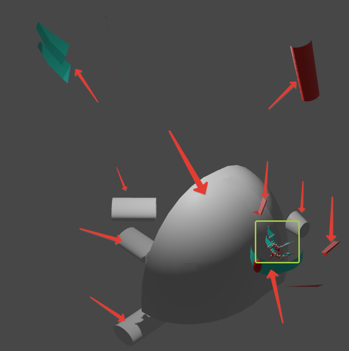

    Here is my file
    Unfortunately, when I view this in sneak peak:
    kurumii
    When I hide the original objects:
    kurumii
    It only seems to work in Blender? How do I get the instance to work in verge3d as it does in Blender? Thanks
    #66850
    The original objects and their instanced copies are exported. You just don’t see them behind the mess.
    The reason of this mess is either in wrong objects’ scales (scales should be reset to 1 ) or in the fact that those scales are animated (what for?).
    One more thing to know: objects in instanced collections have no animations. Actually, they are useless…

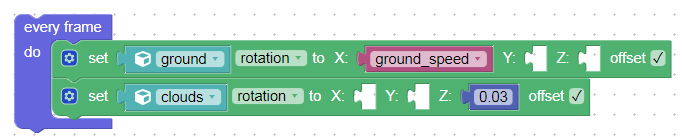

    That said, what does this compute?
    kurumii
    #66921
    That’s the incremental side moving. 0,1 meter per frame.
    #66926
    c4cc
    I see. Why would it be incremental, when the moving seems to happen in one go?
    #66928
    No. It happens in 10 small steps. One step per frame, 0.1 meter per step. The visible speed depends on the frame rate.
