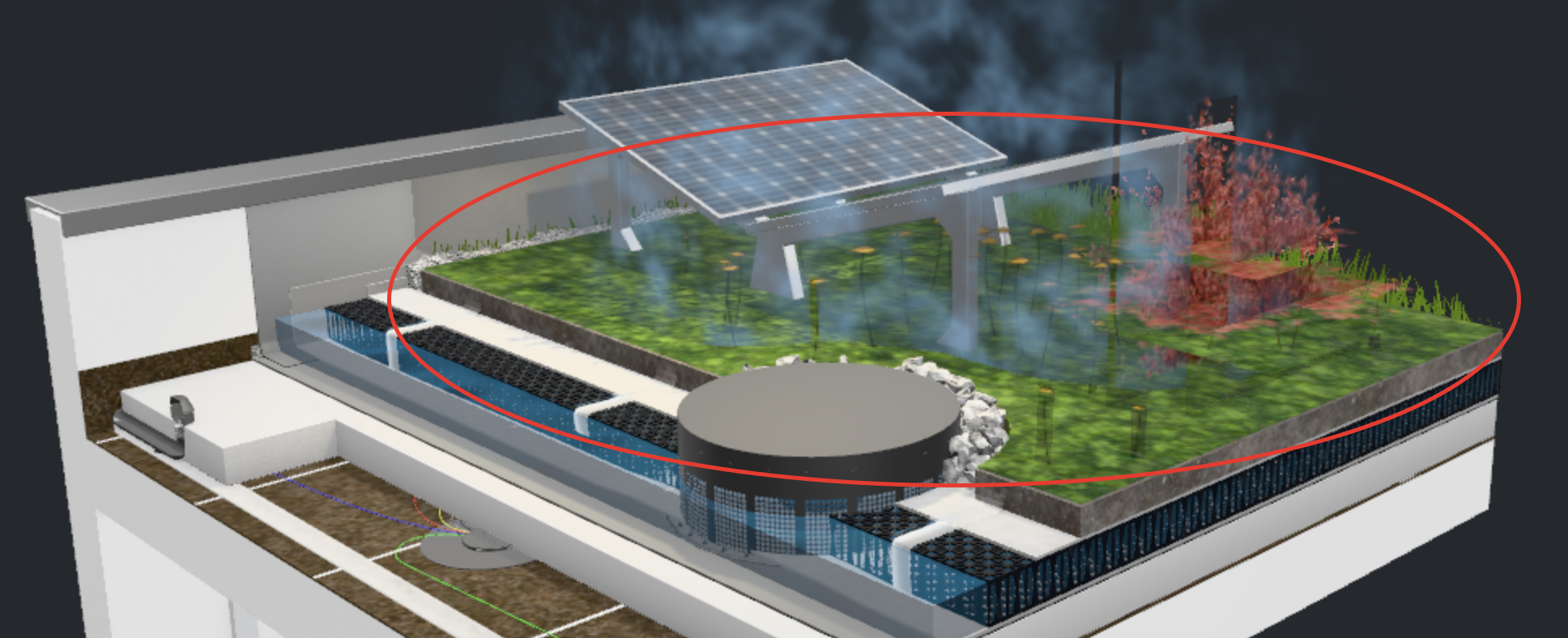

    we have done that app recently and wondering how we can fix the transparency issues on the dandelion and bush. the grass is made also with simple planes and has also an issue were the boarder becomes blue. any suggestions here?

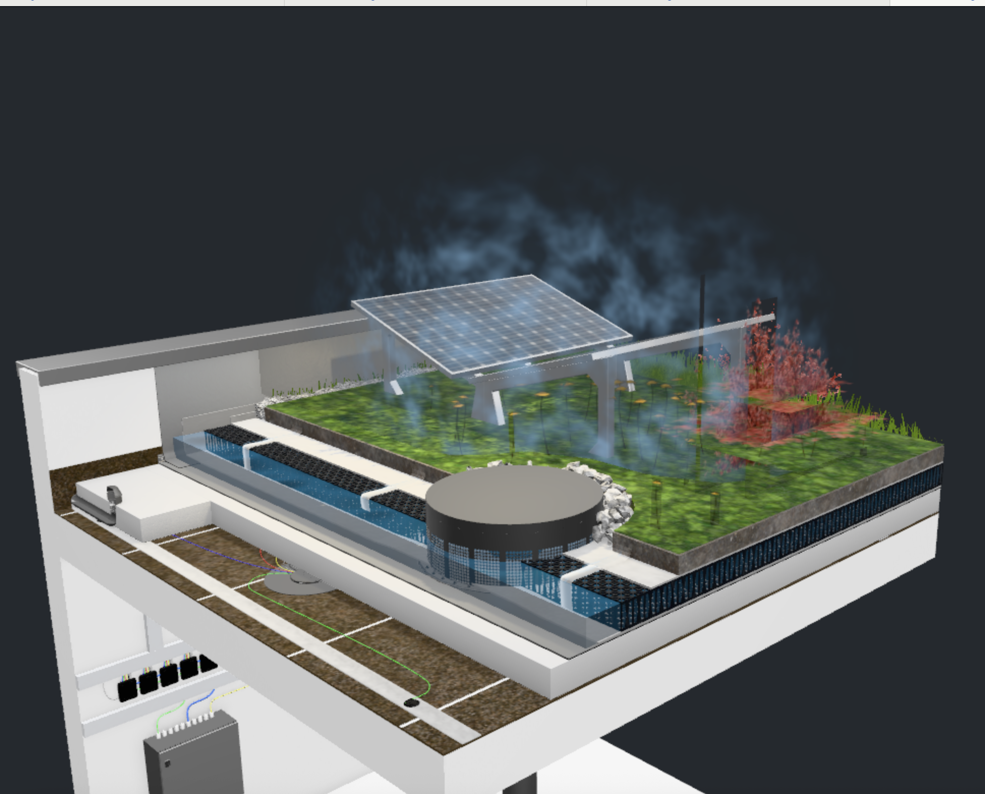

    the grassfield with dandelions is one object which can only have one definition about transparency. i could split it up but it seams to be an issue with orientation of a transparent plane aswell. if you turn the see you will notice that the “dark” transparent planes are not visible form all views.

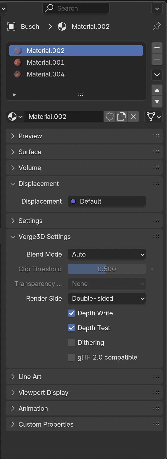

    my settings:
    object with transparency; blend mode auto, double-sided, depth write, depth test

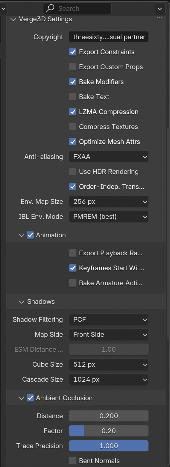

    Verge3d; FXAA, OIT

    that’s an OIT issue…
    it should work this way https://v3d.net/1885

    this is what it looks like if i disable OIT and set AA to auto with depth write off on the objects.

    all materials that are not supposed to be transparent should be set to Opaque. and disable “depth write” for all materials that use Alpha blending.

    i have now changed all materials that are not transparent to opaque.
    i have oit on an disabled depth write on materials with alpha blend.

    Actually, it doesn’t matter how Max or Blender can handle transparency. What matters is how v3d.js (or three.js) can do it.
    move the outlined part of your model into a separate .blend file and attach it here. and don’t forget to attach textures too.
