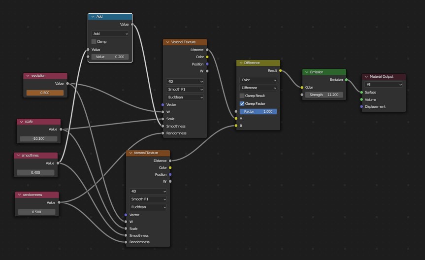

Trying to do some fake caustics animating a shader. How can I import the shader anim into Verge? Could I map it onto the emission of a spotlight?Ref: https://www.youtube.com/watch?v=X9YmJ0zGWHw

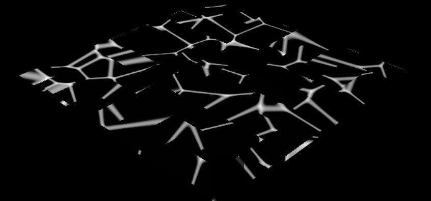

CustomerWhat a great software Verge3d is! Getting this weird tiling texturing issue when I export to verge. Any ideas? (see pics)
2025-01-07 at 4:01 am #79690
xeonCustomerCan you provide your project file wit the texture….or at least the shader nodes that we can look at?

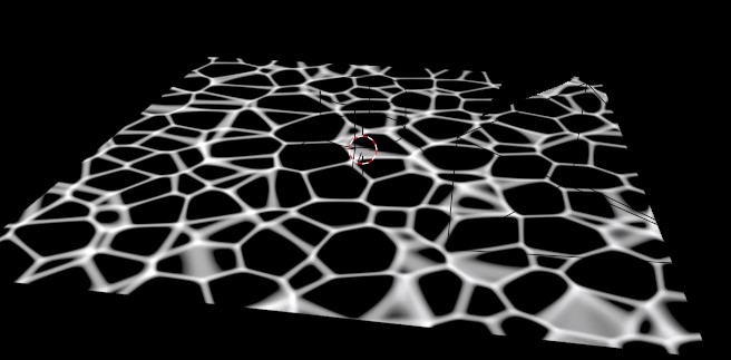

xeonCustomerHi there…after reviewing the file you will find the problem in your shader nodes.
Although the Voronoi Texture is supported its really only has limited support. You happen to be using two things within that node that are not supported. You are using “4D” and “W” you will have to change to settings to 3D which will eliminate the “W”. You can read more about this here: https://www.soft8soft.com/docs/manual/en/blender/Shader-Nodes-Reference.html#Voronoi_TextureWith respect to uploading zip files. The V3D App Manager supports uploading zip files to the soft8soft CDN. You can find more info on this here: https://www.soft8soft.com/docs/manual/en/introduction/App-Manager.html#exporting_applications
Tutorials - https://www.xeons3dlab.com2025-01-09 at 5:31 pm #797442025-01-13 at 5:08 pm #79802boing
Customer@xeon in case you are interested, here is how far I got: https://jayceee.com/wp/CLIENTS/UnderwaterDefault.zip
