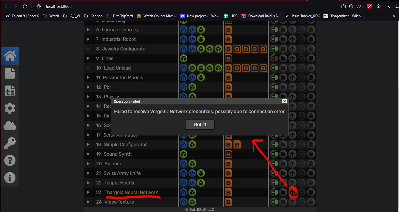

E PParticipantHi
Very New to verge3d and tried and had no problems with trial version when it came to publishing my project.
After purchasing a freelance license I Get this error when I go to publish “Failed to receive Verge3D Network credentials, possibly due to connection error.”
Today I even reinstalled and before putting the license key, tested publishing in the trial again and it worked. Then sure enough after putting in license it gives me the error.Am I missing something? Any feedback would be greatly appreciated :)

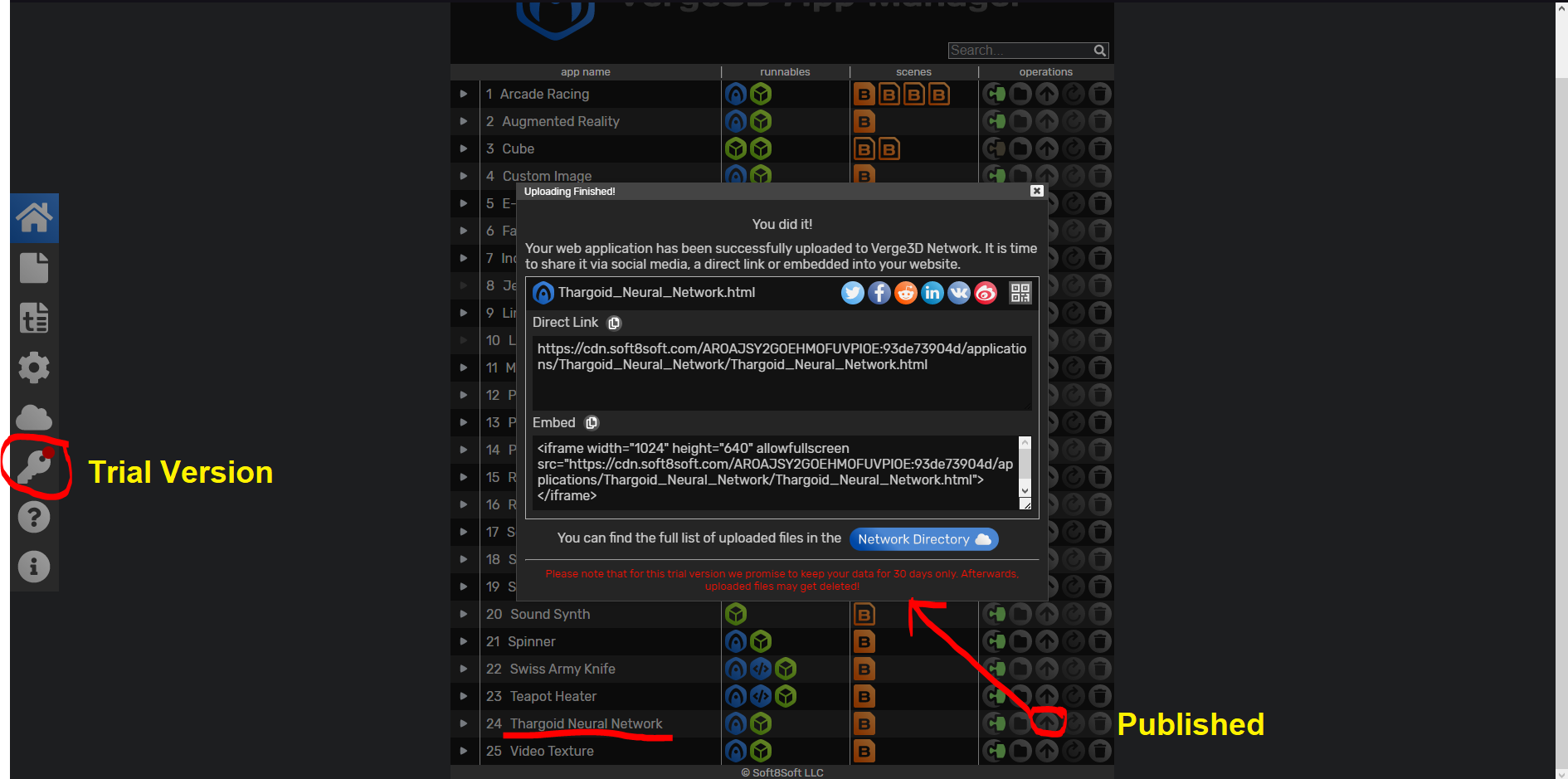

E PParticipantThe trial version worked with no problems when publishing the model. Reinstalled verge3d to test this. License version however spits out this error.
And Checked the firewall and all is good as far as Blender.exe(Unless this isn’t the one in question for port access). But why would the trial version publishing work but licensed doesn’t. Noticed Freelance does support the verge 3d network.
