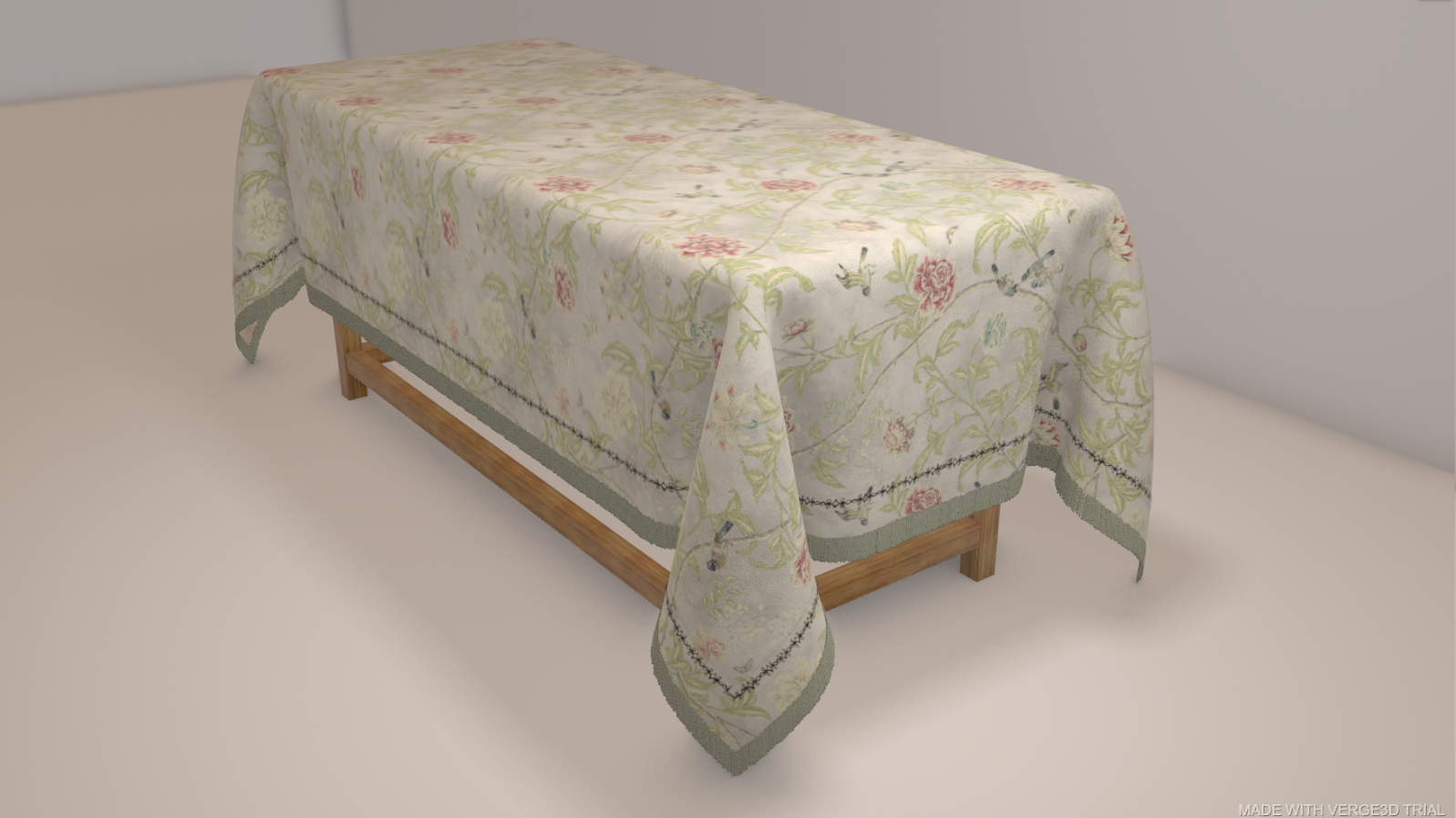

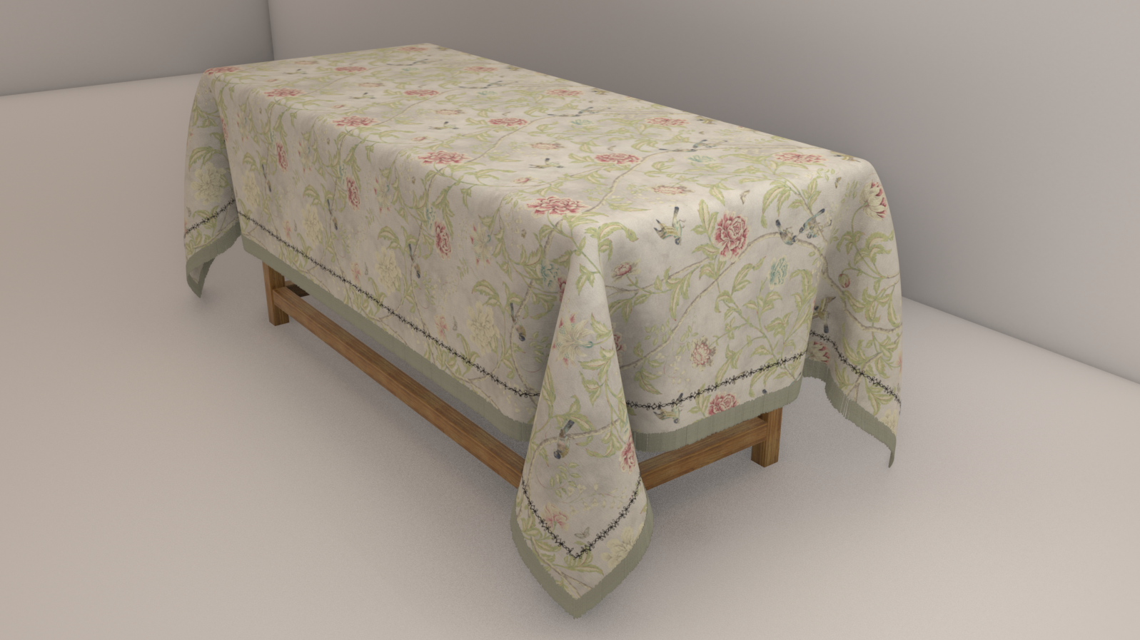

    We are protyping a configurator for tablecoth products and we sent a few screenshots to our client, one from the Eevee viewport and another one from the Verge 3D viewport (currently in trial, if the client approves they will acquire the full license).
    We have notices that in Verge 3D, the cloth texture loses definition as it gets farther away from the camera when compared to the Eevee screenshot. Is there a way to help fix this? The cloth has been scanned and has correct albedo, rouchness. and normal maps… We are attaching both screenshots. Many thanks.
    #84768
    threeamigos
    I missed adding the second attachment with the Eevee screenshot, adding it now.
    #84783
    yes, you can enable anisotropic filtering for this texture
    see https://www.soft8soft.com/docs/manual/en/blender/Shader-Nodes-Reference.html#Image_Texture
    #84791
    threeamigos
    That worked wonderfully thank you son much!!
