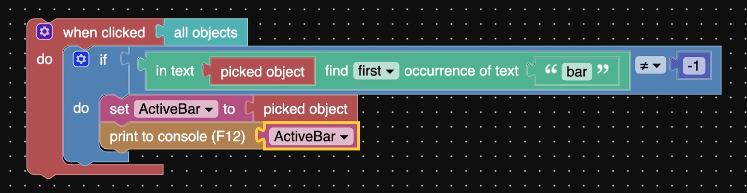

    #74891
    You may find this helpful.
    https://www.soft8soft.com/docs/manual/en/puzzles/Events.html#picked_object
    Best when used with when click and all objects. You can create a if statement to insure the object name suffix is correct then take action

    For future reference and other people that may struggle with this like I did, here’s what I came up with after Xeon’s awesome insight:

    Since you are using the “all objects” puzzle…you will want to validate the user has not clicked on something else other than the required objects. In my example below I am assuming;
    the original objects name has the word “bar” in its name and that no other objects in your scene have the word “bar” in their name. If so this will work.
    Because their could be other objects in your scene that are not clones…any object you click on will return the name of the clicked object. This may or may not be what you want. So this logic ensures only the objects with names with the word “bar” in them will execute your command to print to console.
