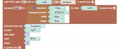

    Is there a way to draw line from one object to the other, like from a 3d cube to a 3d sphere? (instead of an html element like in attached puzzle pic)

    Thank you for coming to the rescue. I think a Puzzle setup would be great. Something lightweight.
    #82601
    You can just create a simple plane object and use shape keys to draw it on off. You can use constraints and or bones to lock it to other objects… use simple puzzles to control
    #82605
    Indeed, direct object-to-object lines are considered but not yet supported. You might use the method suggested by xeon, or implement this feature with JavaScript.

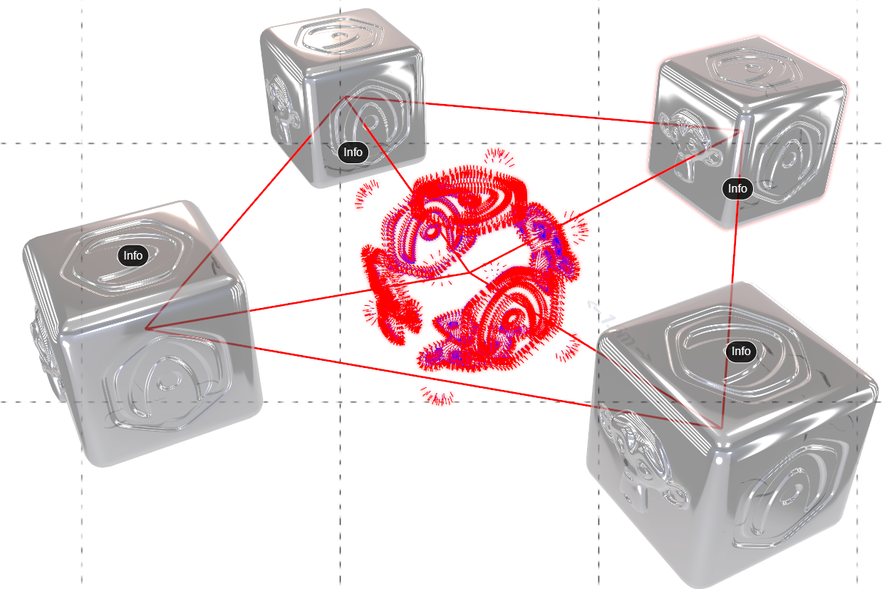

    Yes
    #82637
    I absolutely recommend this plugin :good:
