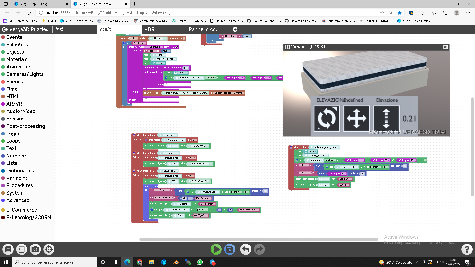

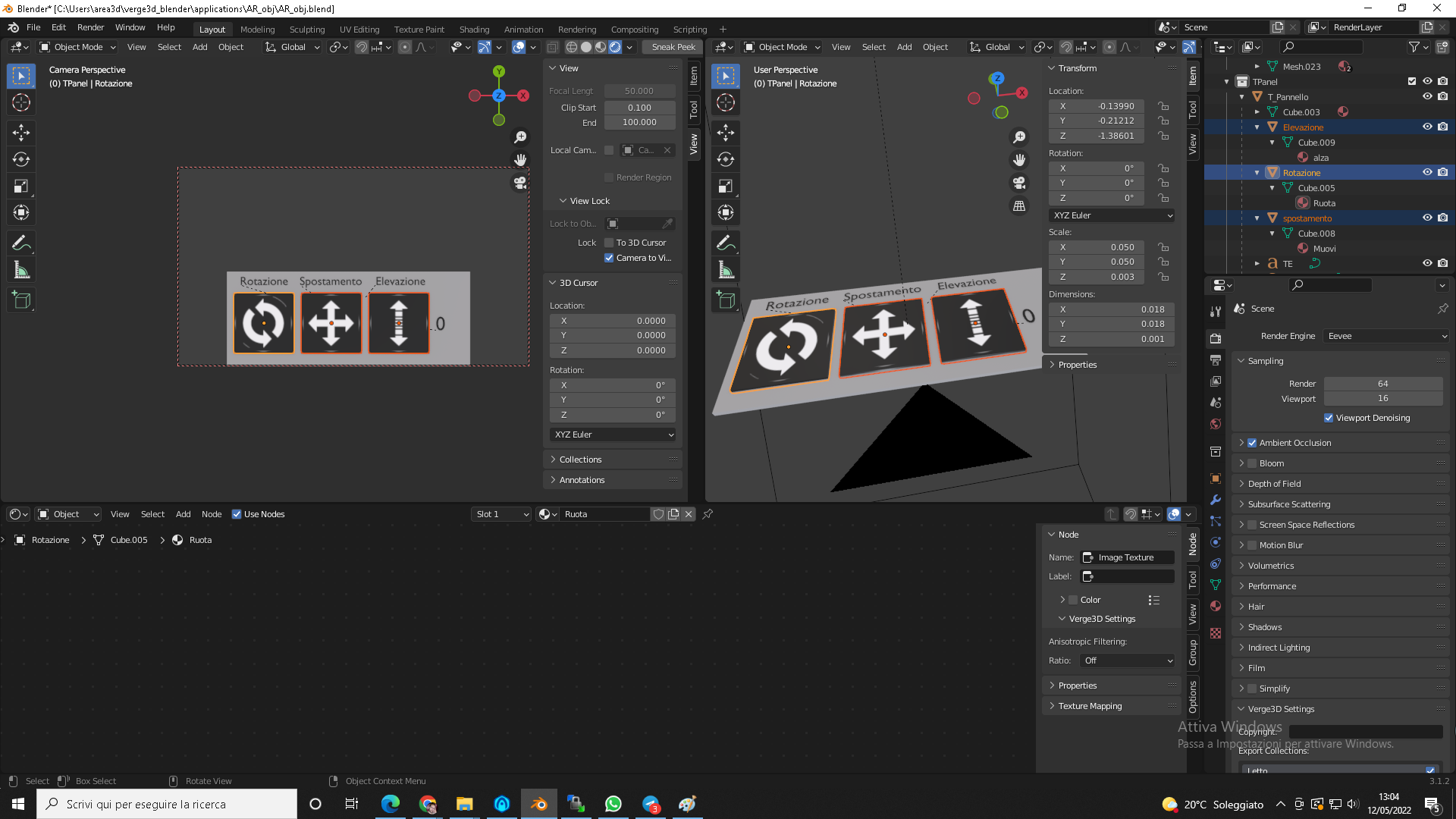

    I’m tryng to move an object in AR mode by dragging over 3 buttons, one for the rotation, one for the planar movement and the last for elevation moves.
    Before entering in AR mode they all work.
    After entering in AR, the last one does not work.

    Hello
    I have noticed that it works, but it seems to be affected by a bug.
    If I’m close to object, it seems not to work, but as I walk back and I get more far from the object it starts to work. More is the distance, more is the movemet response to the drag.
    Is it correct? why?
