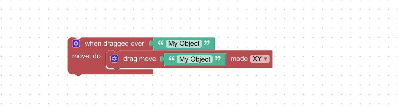

    #86839
    when dragged puzzle works a bit differently compared to when clicked. All objects/groups (but not string names) should be resolved after you append the scene. So in your case the most straightforward way to use this puzzle would be assigning puzzles for all possible objects that can be dragged (if the amount of code is large, use procedures to reduce it).

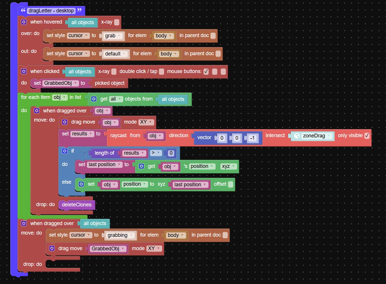

    NaxosCG
    Here is a test where i set back the dragMove puzzle i was using for early tests, just put “all objects” in the list :
    https://v3d.net/1fq6
    PLEASE don’t share for now, it is still in dev. I’ll share the final customer’s link when finished.
    As you can see, all can be dragged, except lettres (you have to open the 3 bars menu, then click some letters) The letters are merged using “append scene”
    See attached screenshot for puzzle

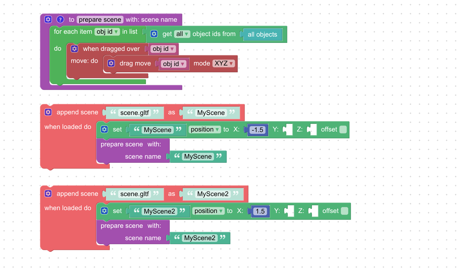

    #86887
    I see!
    Then you can try something like that:
    The idea is to register (or re-register) the drag event once the new scene has been loaded. In the snippet we also used UUIDs to mitigate the same-name issue.

    #86894
    This method will set all objects to be movable, won’t it ?
    There is a name filter for the corresponding puzzle that can help a lot in your case :yes:
