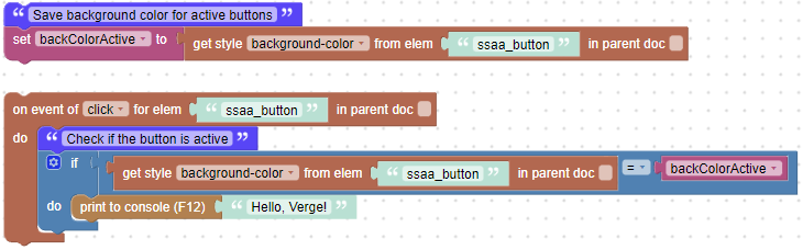

    #54494
    Just do nothing when the buttons are faded. Check the background color value in CSS using get style puzzle.

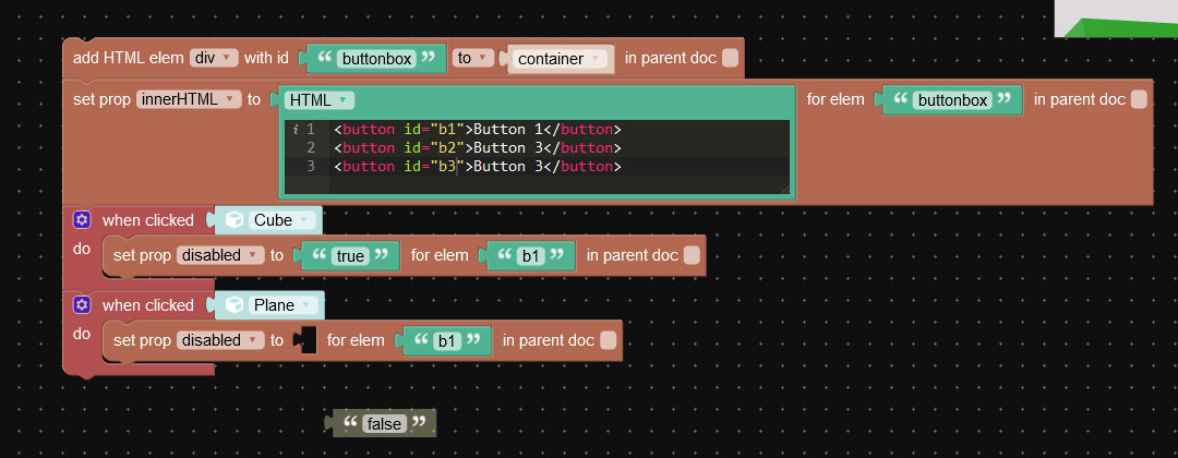

    Crunch
    Or, if you are working with HTML elements, probably simpler to set the element to disabled.
    To return it enabled, leave the “to” slot in set prop button empty.
    Probably also want to create a :disabled pseudo class in your css to control how it looks in disabled mode.
    #54504
    this works only if the html element is <button>. <div> and <a> ignore disabling…
