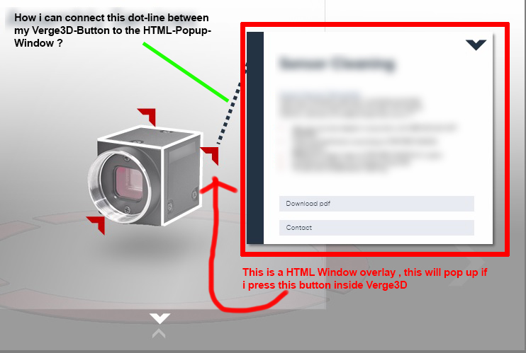

    I am currently making a Verge3D application.
    A freelancer will design the HTML environment.
    I have a button in my Verge3D project.
    When clicking on the button, an external HTML window should open (not within Verge3D), i.e. as an overlay.
    The client wants a dashed dynamic line between the popup HMTL window and the Verge3D button. The Verge object can be rotated freely, so the Verge button is always in a different position, but the HTML window is fixed in the same place…
    Thanks and greetings,
    Martin
    #71886
    You can do it using this puzzle. But the line will be solid :unsure:
