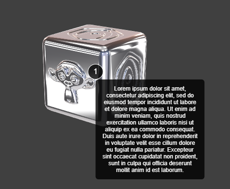

If you want to fill the content of annotations with some text that you have in the application html file, then you can do it the following way:
1) Define the annotation text somewhere in the application .html file within an html element with a unique id (e.g. “annoText1”):
<div id="annoText1"> Lorem ipsum dolor sit amet, consectetur adipiscing elit, sed do eiusmod tempor incididunt ut labore et dolore magna aliqua. Ut enim ad minim veniam, quis nostrud exercitation ullamco laboris nisi ut aliquip ex ea commodo consequat. Duis aute irure dolor in reprehenderit in voluptate velit esse cillum dolore eu fugiat nulla pariatur. Excepteur sint occaecat cupidatat non proident, sunt in culpa qui officia deserunt mollit anim id est laborum. </div>2) Use the id of that html element to get its content via the get_attribute puzzle (select the “innerHTML” attribute):
And you’ll get something like this:

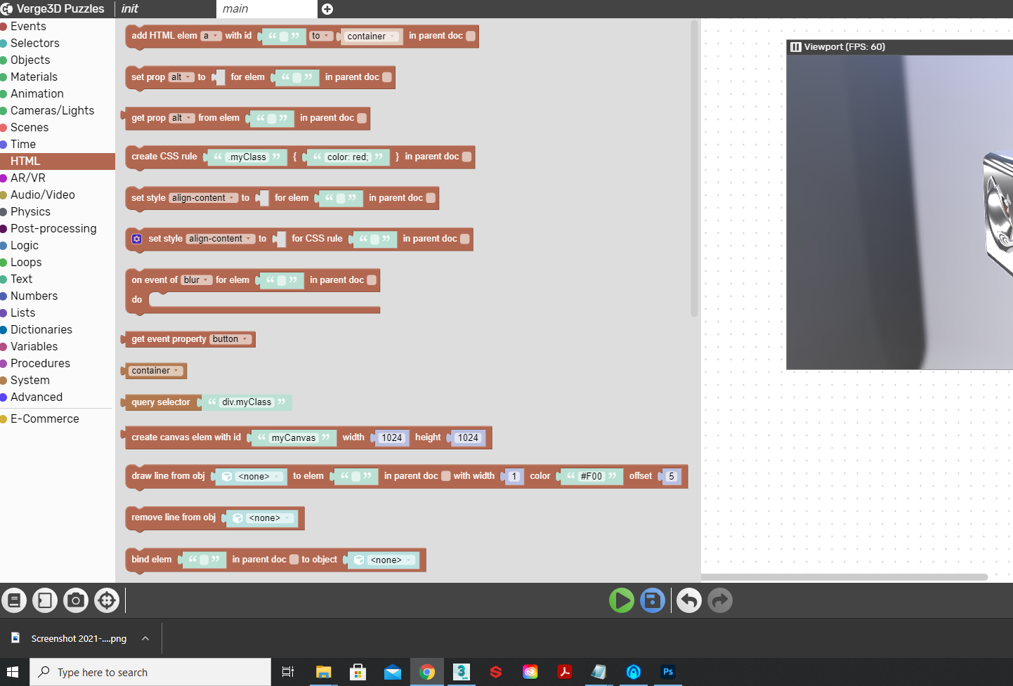

I will give it go. So if the ‘get attribute’ puzzle no longer available, what would be the replacement. See the screenshots

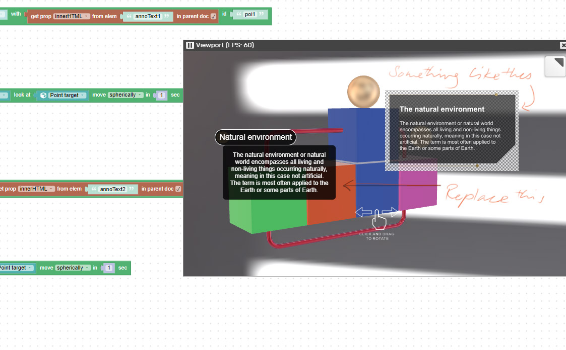

Also, can I have a custom-made bg for the annotation as per the attached image? so the bg can be hdri sky. I believe this would need another CSS. Right?
2021-05-10 at 4:07 pm #40889rdias
Customerhi, ‘get attribute’ is sorted. you’re right, followed the steps! I used the ‘get property’ instead. thanks
Now I’m wondering how to change the bg image for the text annotation paragraph. Any help?

Mikhail LuzyaninStaffI will give it go. So if the ‘get attribute’ puzzle no longer available, what would be the replacement. See the screenshots
It was remaned to “Get Prop”.
Not sure about HDRI, but you can use common image as background changing background-image of the div’s css, no need for another CSS.
