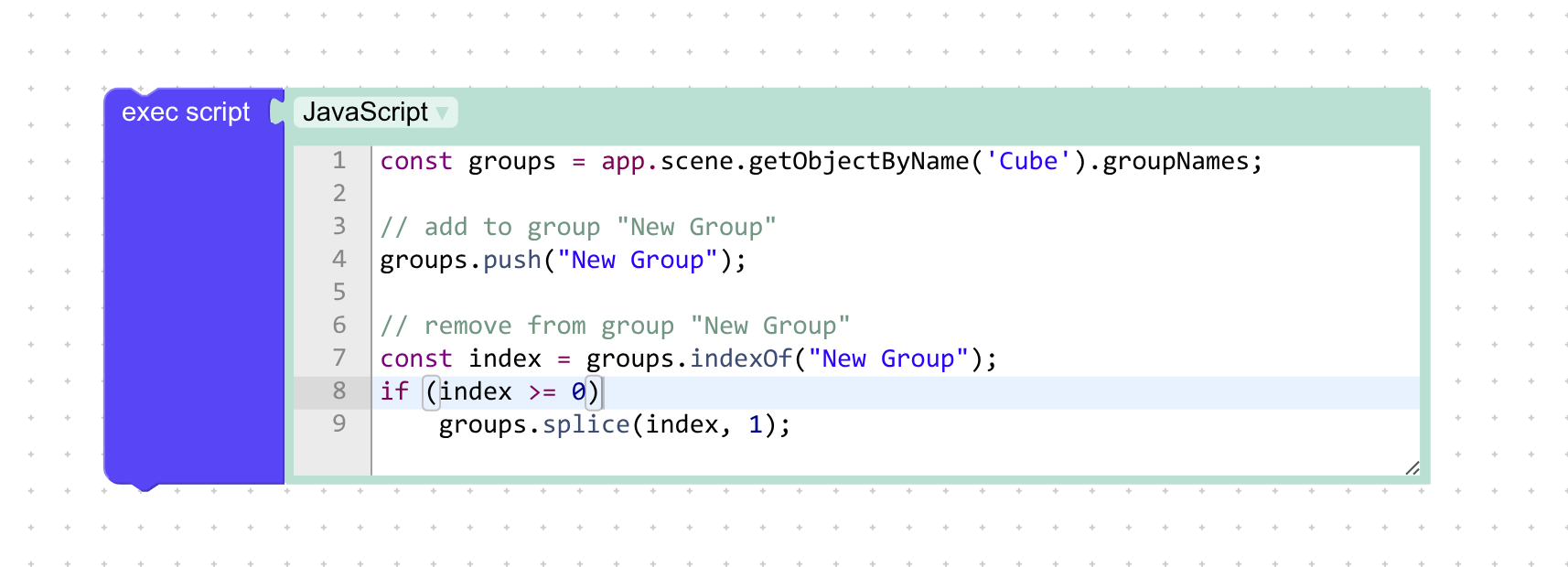

    Meanwhile here is the exec script setup to add / remove objects to/from a group.
    const groups = app.scene.getObjectByName('Cube').groupNames;
    // add to group "New Group"
    groups.push("New Group");
    // remove from group "New Group"
    const index = groups.indexOf("New Group");
    if (index >= 0)
        groups.splice(index, 1);

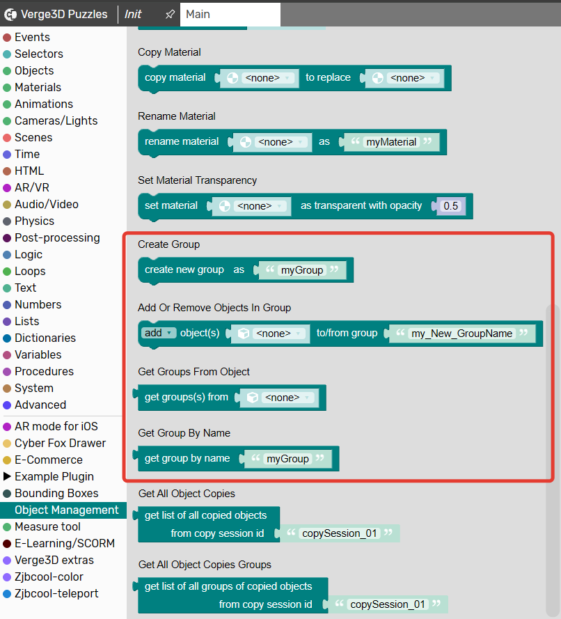

    #83442
    Is there a way to assign an Object to a Group using puzzles?
    Is there a way to create a new Group using puzzles?
    https://www.soft8soft.com/topic/gliftek-plugin-pack-object-management/
