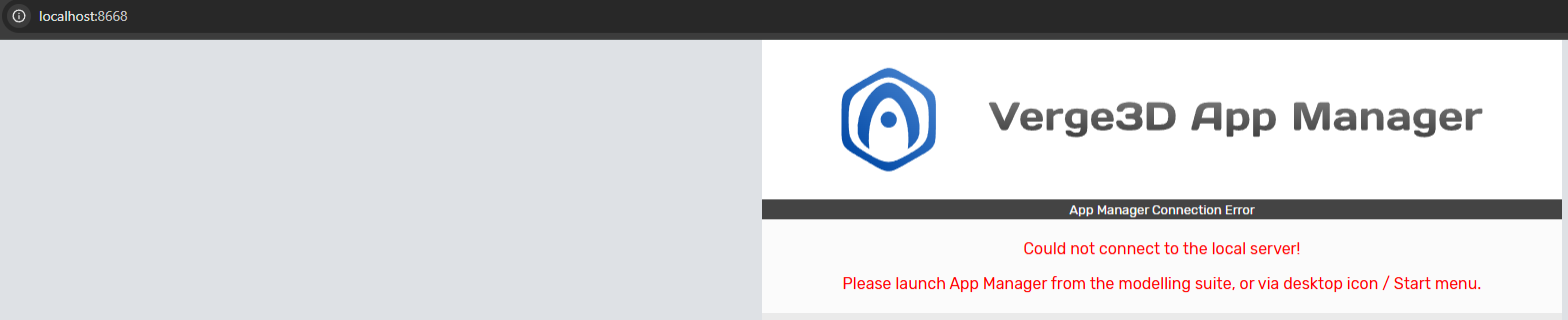

    I just updated to Verge4.10, now I get a connection error.
    Reinstalled and tried opening the app manager from blender and from the desktop icon.
    How do I solve this?
    Thanks in advance!

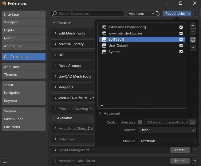

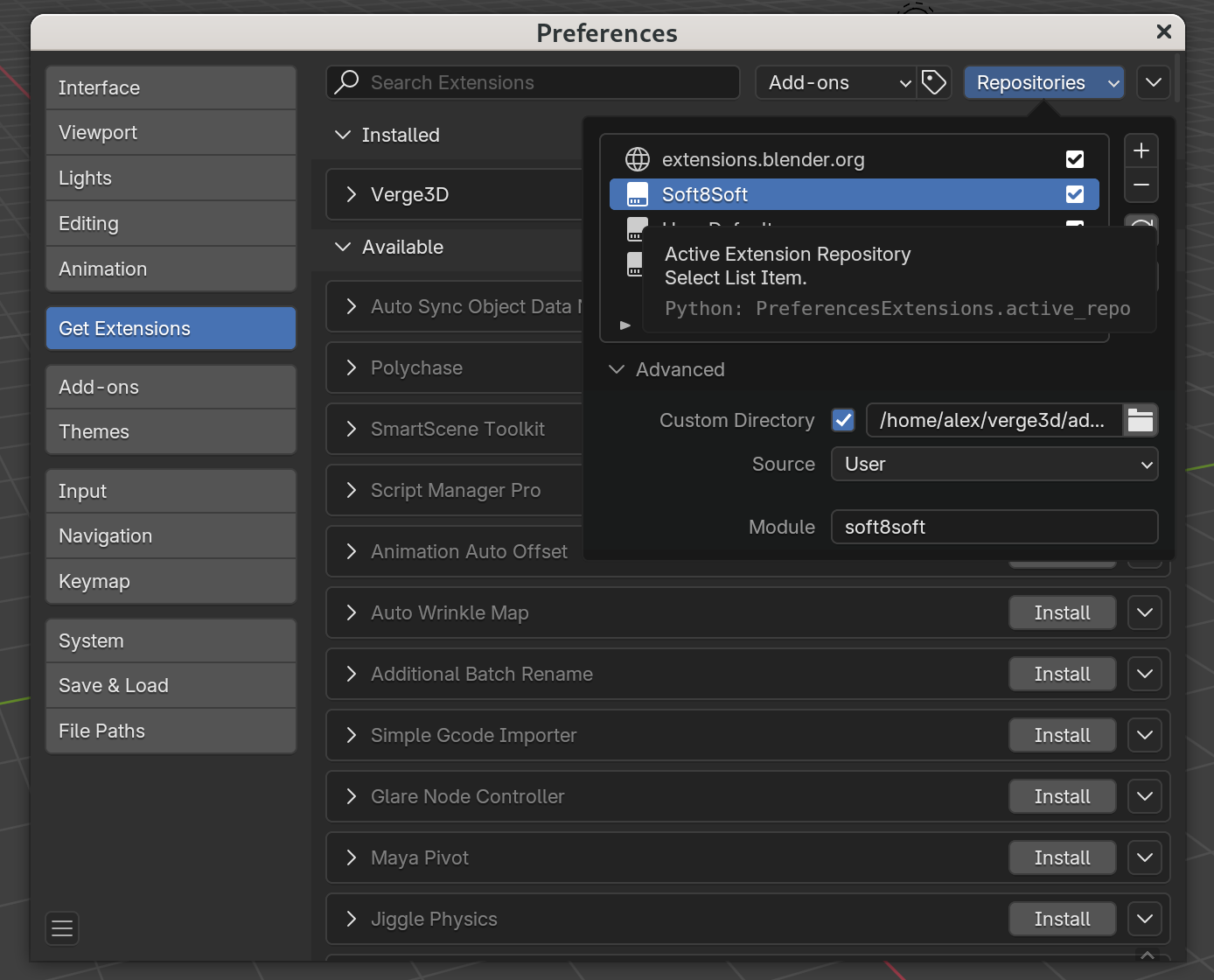

    That’s strange! Please check out the following page in Blender preferences:
    It should display exactly one “Soft8Soft” repository pointing to the installation folder. Also there should be a single installed Verge3D extension.
    #83116
    martenmonoz
    all seems fine but still no luck. :unsure:

    Yes, this is the error in the blender console: V3D-PU-WARNING: App Manager connection refused
    The verge launcher window opens for a split second then closes again.
    • This reply was modified 1 year, 2 months ago by martenmonoz.
