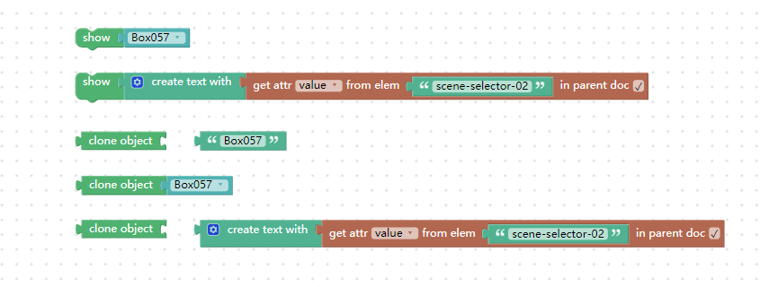

    i noticed that “text puzzle can also be used to provide names for objects, materials, animations or groups instead of the relevant selector puzzles”
    so “cube” = selector puzzles named cube.
    i made a selector following the “scene_selector” in the “load unload” application. jast like this:
    create text with get attr value from elem “scenme_selector” in parent doc-
    when i clicked the selector,i can get the value of the selector,then i can get the object.
    i can show it,hide it,but can’t clone it
    #33326
    this looks like a bug! thanks for reporting
    as a workaround you can save the object name to a variable and then use with the clone puzzle

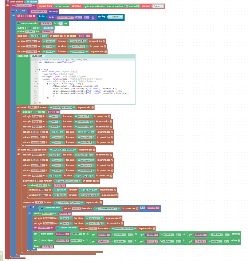

    fisrt,i find that the object i get by clone.it’s status is not stable.sometimes when i click it,i can’t get it’s information,and others i can get it.
    second,when i clone an object i selected and replace the object in the primary position i clicked,the new cloned object’s information can’t show.shoud i save the changed scene firstly?

    We are using clone in a project. The customer needs this function. But the time is a little tight, so we need to explain it to the customer. In addition, I have a question: when I write a clone separately in the puzzle, I can get the information of the generated clone object and display it when I click the object. However, in the event of clicking an object, when I click the generated clone object, I can get the information of the generated clone object, Unable to display information,It seems that the new cloned object is not in all projects. can this problem be solved when updating?

    The cloned object can’t get information when clicking. I made a test video, you can have a look

    I’ve checked your project. Not sure if this is the reason, but it looks like you are creating 2 clones. You should only use the clone puzzle once, and save the result in a variable, and use this variable for setting the position and rotation.

    yes,I did create two clone objects. In fact, if I create only one clone object, I still can’t get the corresponding information.But the effect I want to achieve is: when you click any object and select the object you want to replace in the corresponding information bar, you can complete the clone operation and let the cloned object replace the original object. Now it seems that these have been realized, but the cloned object can not display information like the original object. I wonder if there is any problem with my puzzle?
    #33508
    I think the problem is that you assign a ‘when clicked’ puzzle to ‘all objects’, but the clones are not created yet, so ‘all_objects’ puzzle does not contain them. As such, no clicks are registered.
    You might try to assign a new ‘when clicked’ puzzle to the just cloned object.
